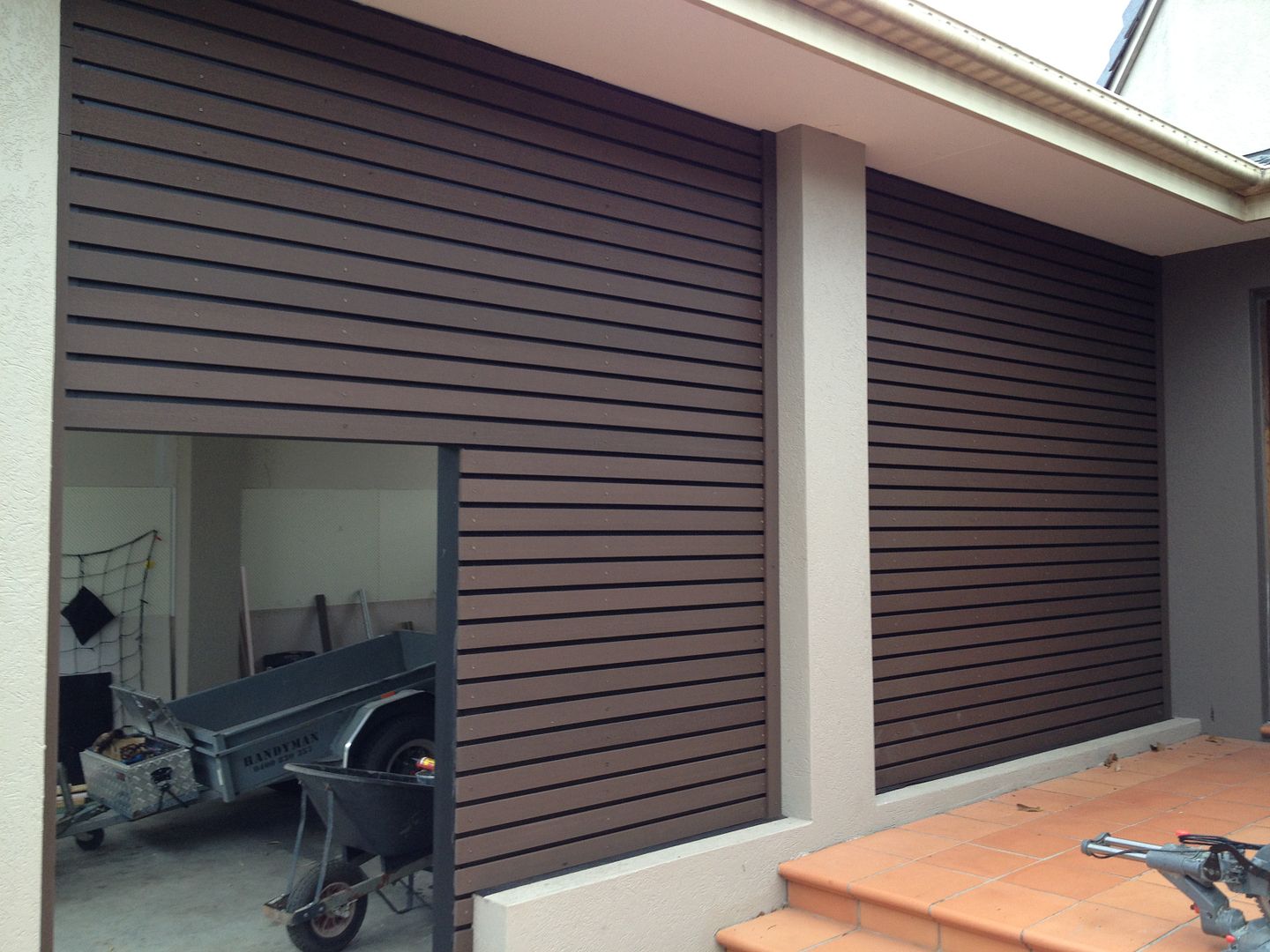

Post Posted: Fri Nov 01, 2013 8:55 pm
I haven't looked in here for a while, some awesome stuff that people do.
I've been needing lock up work space for a while and was considering building a double shed, not really what I wanted. Instead I decided to close in our carport.
Used a pivot hinge just for funky factor, just need to sheet and batten the door once I mount a lock.
Post Posted: Sat Nov 02, 2013 9:56 am
Looks good ZN, what did you sheet it with? Fibre cement sheet or blueboard?
My mate did something similar with a feature wall in his garden, I told him to sheet it and paint it then put the battens on after all coated up and the effect will be good.
He didn't paint it and regretted it when he finally decided on the sheet colour :lol: always rushing things :roll:
Post Posted: Sat Nov 02, 2013 3:11 pm
I was going to use blue board originally but rain rarely reaches this area so I used exterior ply to make attaching the battens easier. Three thick coats of satin black anti corrosion paint, can't remember the type but it should keep the water out well. The battens are Eco-something 45% bamboo, blended mill waste and whatever they use to bind it all together. No need to paint was attractive, hopefully it stands up to the low maintenance claims.
Mrs ZN gives the result two thumbs up
