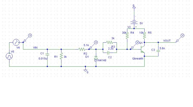

Post Posted: Thu Sep 08, 2011 3:56 pm
Yea the processor seems odd. No info at all on that one! It does run a ceramic resonator at 12MHz, which to me is a bizarre frequency to run at.
The IRF840's with their built in avalanche diode, do you think they require external snubbing circuitry or flyback diodes or would the be internally snubbed and protected?
These are the issues I'm trying to sort out to make the next board, so I get the hardware hopefully spot on this time. The first board was really a training exercise to find out what I missed and require on the new one.
This is the Denso input conditioning circuit which seems to be fairly simple but works really well at least in spice with simulated noise. The simulator shows even better results then my last circuit using the comparator and a descent amount of hysteresis.
I'm going to have to give this one a go anyways since it seems to work for denso, it should also work for me.
Do you know the function of the parallel C2 and R3 components? IS it some sort of 'quickerer' to turn the base off faster? I've seen it used in a few circuits before.
I also stumbled across this very simple VR conditioner circuit which seems to work for this production unit:
Looks to me like those LP RC filters in it would introduce a descent phase delay from the VR signal to the micro...
Dan

Post Posted: Thu Sep 08, 2011 4:57 pm
The first circuit I've seen used a few times before, its a fairly crude set up and you will get timing changes with both RPM and with temperature so you'll need to compensate in software.You'll need adequate decoupling of the 5V supply too because any excess voltage will be dumped into the 5V rail. The negative going swing will be dumped into the ground so that needs to be a good return to battery to have a solid return path too.

Post Posted: Thu Sep 08, 2011 5:18 pm
The second circuit has a HPF and an LPF, it looks more like its for speed detection rather than position detection and over a limited range. Curiously the input goes to an ADC pin as well as what we can only assume to be an IC or other interrupt pin.
The 12MHz resonator is because the clock frequency is divided by 6 to get the E clock which then gives a fairly common 2MHz bus frequency, equivalent to an HD63B01. I would have expected a crystal but I guess that because its fairly low powered the timing isn't that critical.
You may find that the circuit is designed so that the advance generated by the input stage is used to control the timing in 'limp-home' mode. The output from the watchdog may control a mux.

Post Posted: Fri Sep 09, 2011 1:35 am
The second image doesn't show.
Hurmmm do you have any suggestions for a conditioning circuit I could use in this particular case as I have miss-matched tooth/sensor widths thus a true zero crossing IC or detector will not work without inconsistent phase shift?
In regards to the Denso conditioning circuit as you said there will still be some sort of phase shift, how much shift do you think we are talking about? The tooth width is ~10mm which corresponds to ~11* of crank angle and the sensor width is roughly half of that ~5mm.

Post Posted: Fri Sep 09, 2011 1:48 am
That second circuit is not very impressive IMO but for some reason it seems to work acceptable. As said it's in a low quantity production ECU model. It is quite possible that there are a few 'fudge' factors written into the firmware to make it work perfectly but all I know is that it implements a very significant phase shift due to the LP and the input cap.
I had a read of that site to work out the other connection to the ADC, and that is basically implemented as a bit of a hack to get around the low amplitude pulses at cranking RPMs. He seems to RT sample the pulses at low speeds with the ADC and use that as phase input for the firmware until it reaches acceptable speeds. Besides the ADC inputs, the others go to the internal comparator in the MCU.

Post Posted: Fri Sep 09, 2011 6:39 am
I'd stick with the comparator circuit although I did use a similar transistor circuit about 20yrs ago in a PIC based ignition. The switching transistor was followed by a schottky trigger to square up the waveform. If you don't have a schottky input into the micro then you need to ensure that you meet the minimum rise time spec.
Fot the phase shift its easiest to run it through the simulator and measure it at different rpms, the frequency that the filter will see will be the equivalent frequency of the pulse rather than the repetition rate.

Post Posted: Fri Sep 09, 2011 8:33 am
The watchdog timer will be just a watchdog, its not very accurat, that IC is common in Densos of that era.
I used the datasheet for the HD63B01, other than the clock I didn't find any other oddities, the AW ECU didn't use any of the Hitachi extended instructions but I haven't tested to see if the MCU supports them.
Hurmmmm so you reckon the comparator setup will be my best bet ie the circuit I sent you? Also do you know what the effect is achieved by the parallel cap and resistor inline with the base of the denso circuit? Some sort of filter?
The equivalent frequency of the pulse, how would you go about working that one out? I've just been using repetition rates and yea they may work for a perfect sine wave but not for these waveforms.

Post Posted: Fri Sep 09, 2011 9:50 am
So it seems that I'm getting the noise on the VR signal due to the switching of the coils. I'm driving them directly via MOSFET. Do you use some sort of snubber circuit around the drive transistors?
Thanks again for sharing your knowledge mate!
I'd stick with the comparator. I'm pretty sure that the parallel cap is just there to drive the base negative to turn it off faster.
Each 'peak' from the VR sensor is roughly sinusoidal so imagine that they are all strung together without the cap, thats your 'real' frequency.
A snubber is only necessary if you exceed the avalanche rating of the FET, you would have to measure the voltage and current and then do the thermal transient analysis. A snubber will still dump the back emf into the PCB somewhere so layout is still critical. Some manufacturers have used external igniters which keeps the nasty stuff away from the ECU.

I did a little bit more testing and code analysis on the 76C40 used in the Aisin Warner TCM. It seems that although AW only use pure 6800 instructions the processor is much more capable.
I have found that it runs the Hitachi extended instruction set and has an additional Y index register, it looks like there are some extra timer functions too.
So the processor is quite capable but the AW code is extremely inefficient. My guess is that they used the 76C40 as a straight drop in replacement for the 6801 using existing code.
