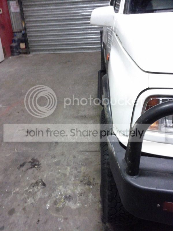

I needed steps - especially with the bucket seats in. Angled them up 45ish deg so they sit just less than a shoe-width out from the sills. Function as sliders and steps , and sit almost inside the line of the tyres (tyres are now 30mm wider than this):
