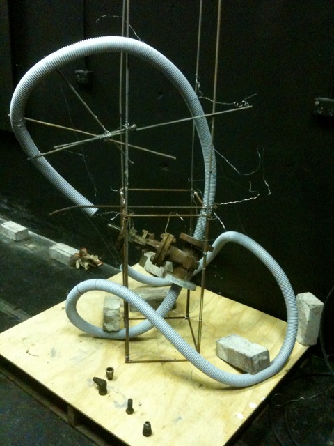

Just wondering if anyone knows of someone who can do a hideously complex bit of pipe bending for a sculpture.
The pipe needs to be 50mm in diameter, in mirror-finish stainless, suitable for outdoor life, and the ends need to be sealed over so it looks like solid bar.
I'm based in Sydney, but if necessary, I can travel
Here's some pics - the sculpture is just the grey pipe (which I'll pack solid with expanding foam as a template), and the valve:
If anyone can point me in a direction that'll help, I'd appreciate it.
cheers
mattg.
