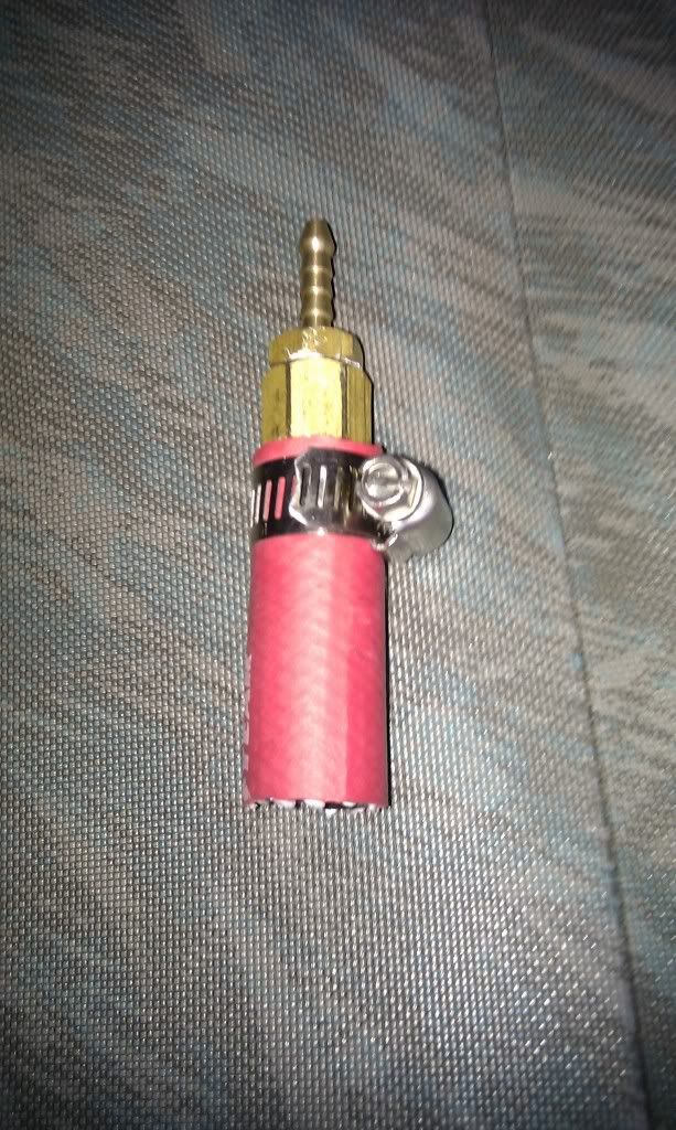

Youll notice in the photo there are some smaller hose clamps for the small hose connections, I did not end up needing these.... the hose that i used was pressed on quite tightly to the barbs so i deemed them not necessary, you may find that you need them however.
I started off by making an adaptor to fit onto the rather large nipples found on the suzuki diff when you pop the caps off.
I used a small length of the 1/2in hose with the barb in one end, and screwed on the smaller barb to make a reducer. Dont forget the thread tape.
Then i attached the 5mm hose to the end of it to start the run from the rear diff to the front

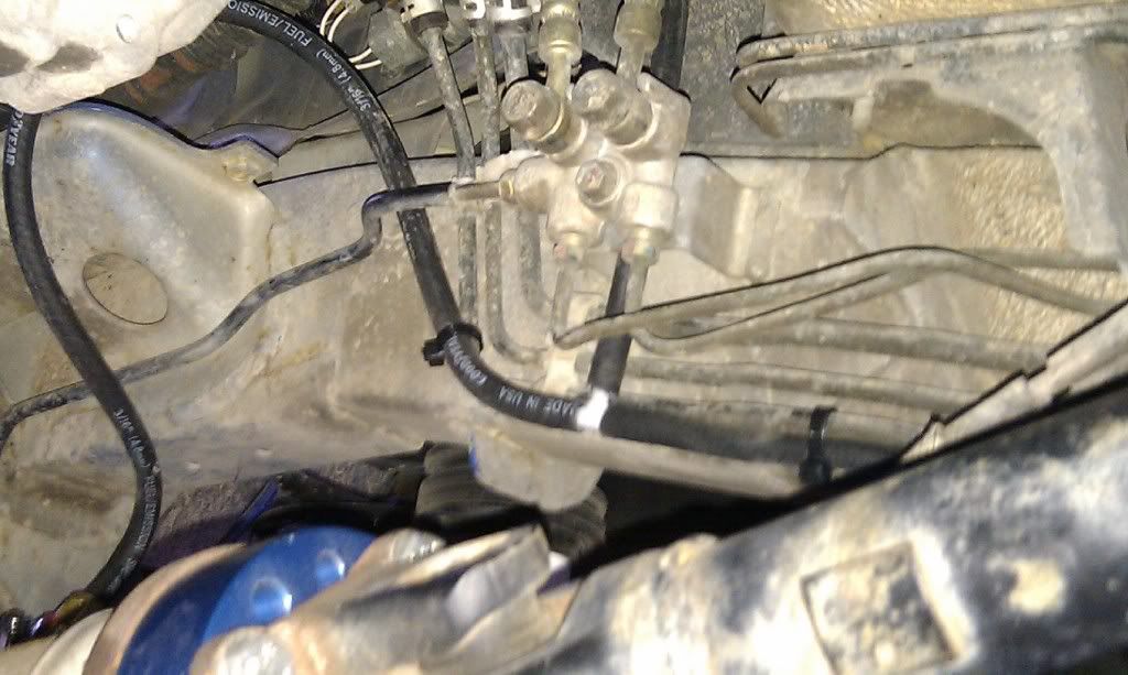

Here it is on the rear diff looking from the front, i have already begun the routing as you can see
once you get half way along the left hand side, i ran mine across to the other side as you can see here
following the right hand chassis rail now using brake lines for cable tie points
Once i got to the point where the hose is to run straight up to the engine bay, I repeated the above procedure on the front diff and put the T-Piece in and ran it up the firewall.
I dont have a pic of the hose hanging out of the engine bay but you get the idea, Now i had to make the fitting for the filter to fit onto the hose, its simply an elbow connector with a small bit of hose to make it fit into the breather filter.
pretty easy huh? now i stuck that on the end of the hose and attached it to the rear firewall with a cable-tie mount (bit of plastic with double-sided tape, buy at supercheap)

Looks good man, bit dubious about the line running under the fuel tank though. Nowhere else that can go?
Joined: Mon May 30, 2011 9:28 am
Posts: 2233
Location: Townsville
Vehicle: 03 Jim M13A no-vvt, Vinyl Spec
Post Posted: Tue Sep 13, 2011 8:07 am
not easily, its actually quite good there, im happy with it. It gets too close to the prop shaft otherwise, or too close to the springs if i keep going past the tank.
The hose has quite a thick wall to it, and its braided, so it should withstand a fair bashing. If it does go to shit, its easy to re-route

http://i1088.photobucket.com/albums/i33 ... 9-2011.jpg
how does it go onto the diff? did you just slide the red tube over the thing that sticks out on the diff?

will still have to make a fitting to suit the diff on the zooks....
