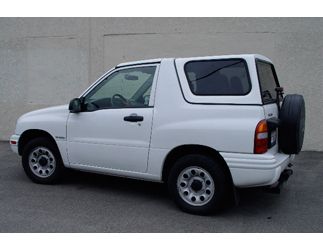

As part of my polymer processing apprenticeship (fiberglass and other plastics) my teacher has set me a challenge of designing a mold and making a part off it. Ive decided to make a hardtop for my swb vitara. Ive had a look on the net and i cant find any for sale in Australia, only in America on rallytops.com.
Ive decided to go for this sort of look, maybe with different shaped windows....
and maybe something different like this down the track....
If any of you like the finished product, id be happy to make a hardtop for your zook. who knows i might even be able to make some $ out of it :wink:
Im going to post some pics up on here as i go through the mold making process up until i have the hardtop fixed to the car.

Thats good, but the top one is a swb grand vitara and you won't have much of a market to sell them because noone owns them!

sorry, i forgot to add that its going to be going on a 1997 vitara not a grand vitara like in the pics, i just used the grand vitara as an example to show what sort of hardtop i wanted to end up with.
