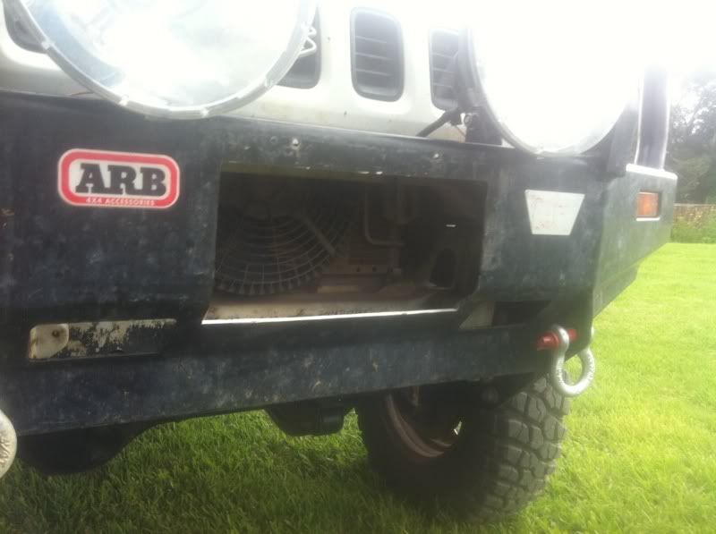

Post Posted: Sat Oct 18, 2014 9:56 am
This is for a jimny but vitara may be similar
Cut hole out
Weld in new cradle.
Finished product.
