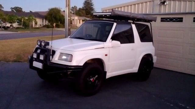

Work lights on your rig are great, but who wants to always have to get into the vehicle to use 'em, I didn't!! Well I did a little mod a while back which comes in handy especially when camping, or need light when setting up camp, working outside etc All lights controlled via a code hopping key fob, but I have also fitted dash switches for when in the vehicle.
Cheers Fellas!
Here's a little vid.

Woah. Impressive set up.
Did you use some kind of kit for this? Details?

Hey Fellas,
Cheers! :D
I bought a 4 channel garage door opener from the local electronics store. Each channel can be set to either latching or momentary via dip switches. Each channel can also be set as normally closed or normally open. It can used set to control light, tailgate/trunk opener, or even as a remote engine start, whatever. The relays are only good for around 5 amps, so you will need to fit an additional high current relay to that channel/s if running a big load. I have found it to be very useful when camping. Jump out of the tent into the pitch black night, tap the remote and BAM it's day! No tripping over crap etc. I've tested the range and got around 100 metres line of sight which is pretty damn good.
The unit is similar to this one - http://www.electronickits.com/kit/compl ... ck1616.htm
Only took around 10 minutes to wire into my lights.
Hope this helps!
