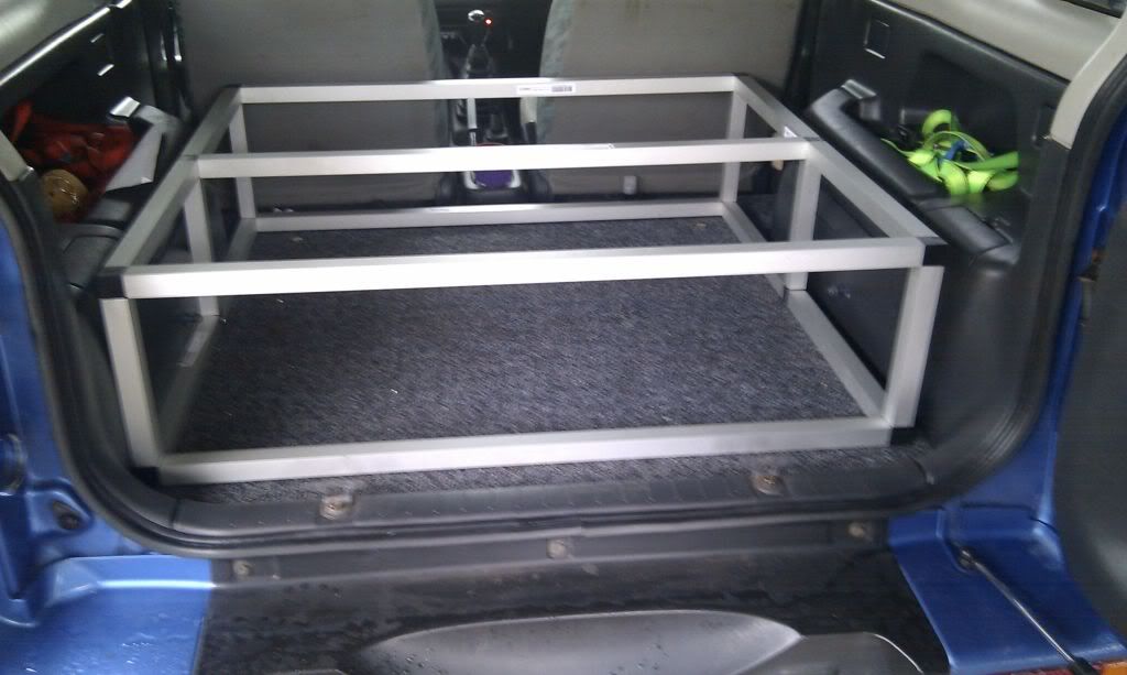

Well I was holding off on posting this until I was finished but I caved.
This is the beginning of my drawer system. Its going to be a single drawer unit, I couldnt justify the loss of space having 2 drawers and its cheaper with one set of sliders. Im going to make a fridge slide (when i get a fridge) to go on top.
Im using 25mm QubeLok aluminium framework and the rest is going to be plywood. QubeLok is the BOMB! so easy to work with and damn cheap. (dont goto bunnings, at least double the cost)
The plan is to have a 240v GPO at the back connected to an inverter hidden at the front of the frame, and maybe some 6x9s on the front too, havent decided yet
not going to have any top access panels. just a flat top, will be in 2 pieces to assist in removal and install.
anywho, pics pretty much sum it up where i am at so far. Ill post a detailed cad sketch and dimensions, build list etc when im finished

Hey, I'm doing the same thing with a few more supports, but pretty much identical.
Dont forget to rivet the joins otherwise they pop out.
Yours looks 100 times neater than mine.

no way they're coming out mate, i had to pull it apart to do some "length adjustment" and i had to belt the absolute crap out of it to get it apart. snapped one of the plastic things it was that tight. the ally is actually 24.4 or something like that so that it fits that way... you may have 25? The bloke at the shop said you shouldnt have to use any fasteners at all. the ply will hold it all together anyways when its screwed down.
QubeLok came from Capral (they are the manufacturer) lucky enough to have one local in Townsville.
At Bunnings its called Connect-It (i think)
each fitting is about 2 bucks
and the ally is around 30 bucks for 6m from memory, it varys where you are in Oz.
I got some 100kg sliders that have lock-outs from ebay for 70 bucks, only got them a day before i left for work. so thats why i stopped where i am now.
There will be some 3mm flat bar ally on each side to distribute the weight more evenly and to make attaching the slider easy.

Looks good, I've made one out of 20mm2 steel tube, bolts to the floor pan where the rear seats mount, and drilled extra holes, stong enough to hold a solid drawer with there 1000mm length, with a mt45 engle on top, it's heavy, but solid! Would post pics, but don't know how to on iPhones!
