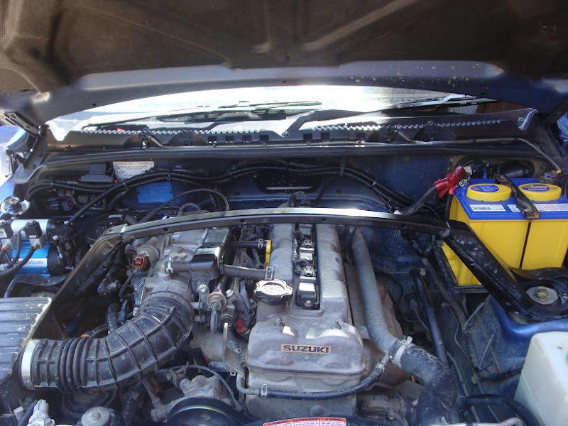

I have been wanting to do a dual battery setup for quiet a while now as I am going on a trip around Tassie next month and I have been able to borrow a fridge.

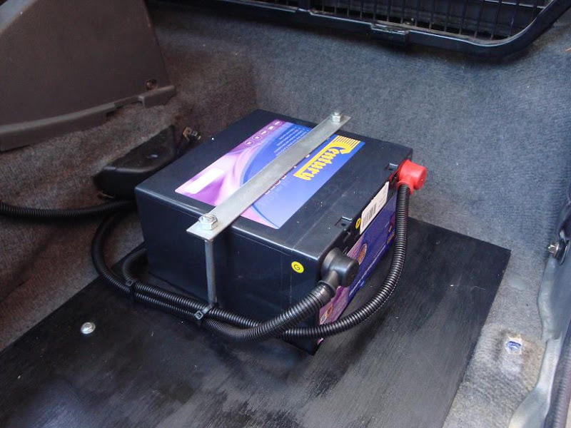

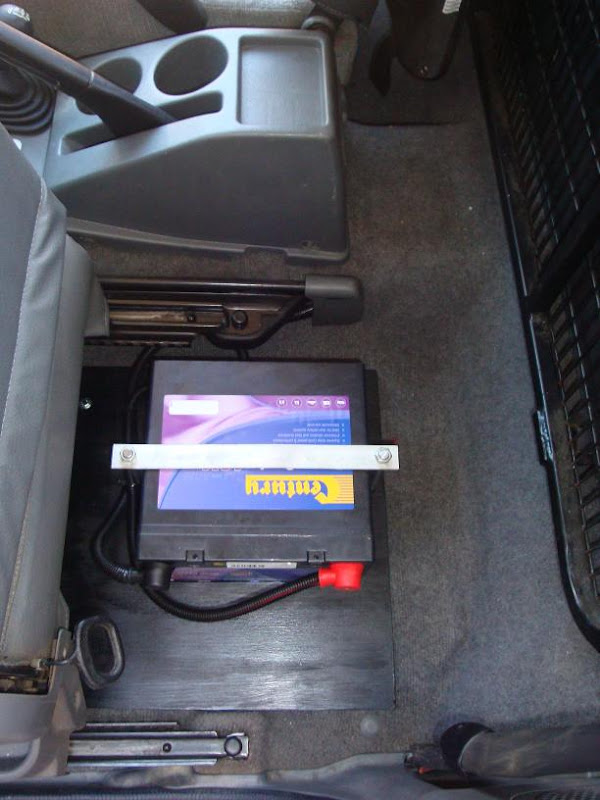

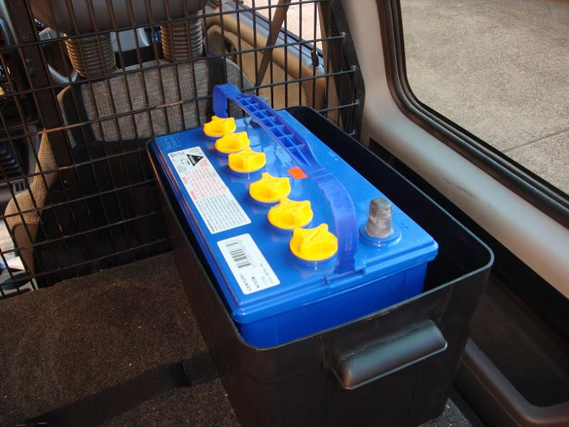

After heaps of head scratching I just couldn't seem to fit a deep cycle battery battery under the bonnet so I decide to fit a battery box in the back on top of my drawers but after I mounted the battery in I just wasn't happy. The battery was large, heavy (just under 25Kg), took up valuable space, high center of gravity and I wasn't happy with a normal type of battery venting into the car so back to the drawing board:

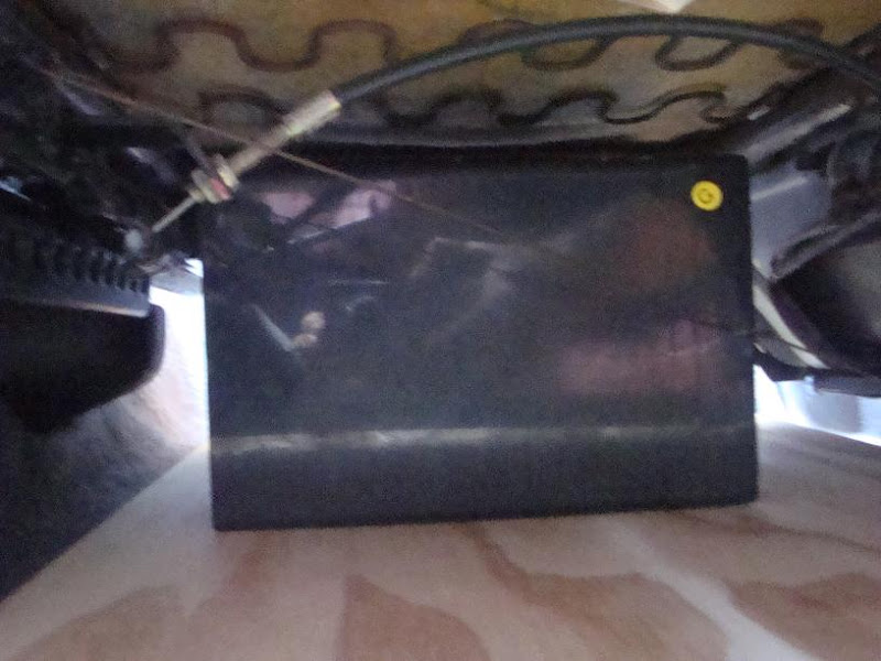

So after reading through some old 4WD magazines on a fridge comparison I though I could get away with a 55AH battery, and if I got a glass pack type I wouldn't have to worry abut the battery venting into the car and I could mount it on the side so here we go:

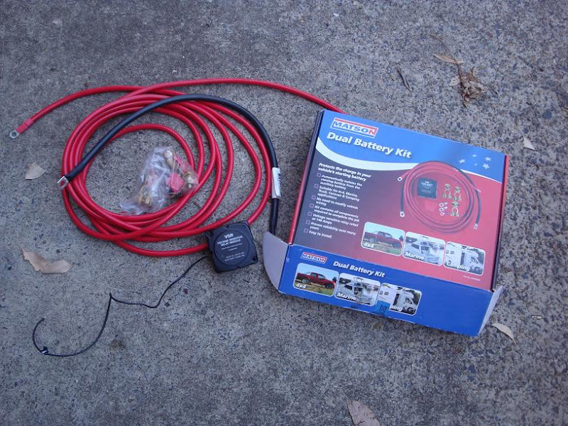

Dual battery kit
has a 12.8 cut in voltage and a 12.7 cut out voltage.

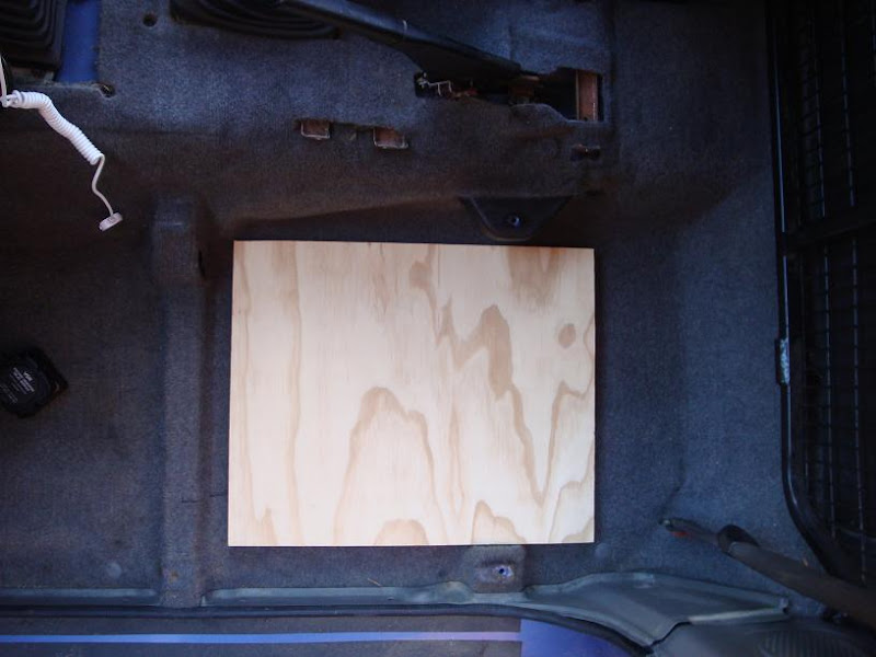

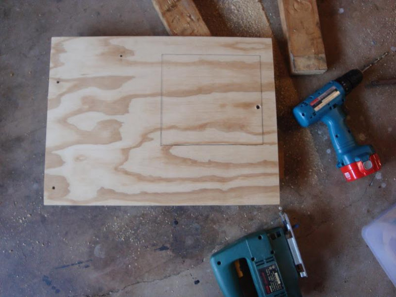

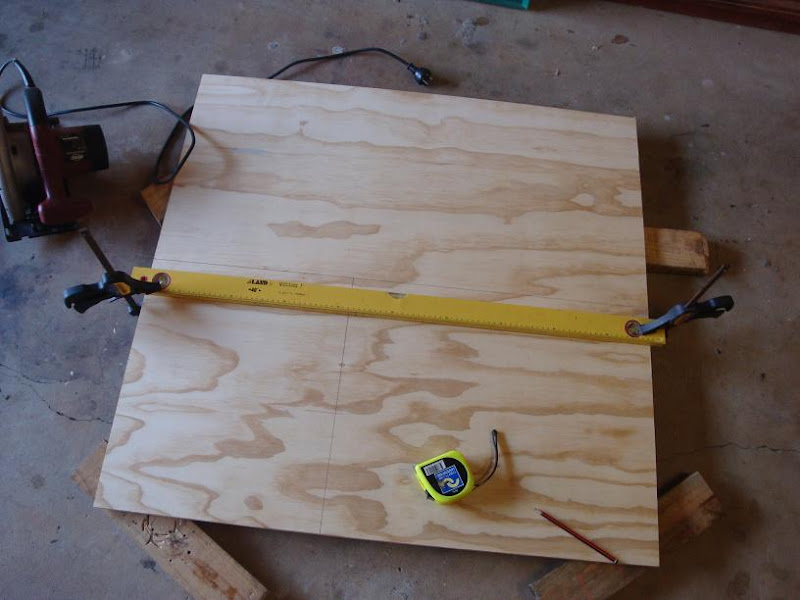

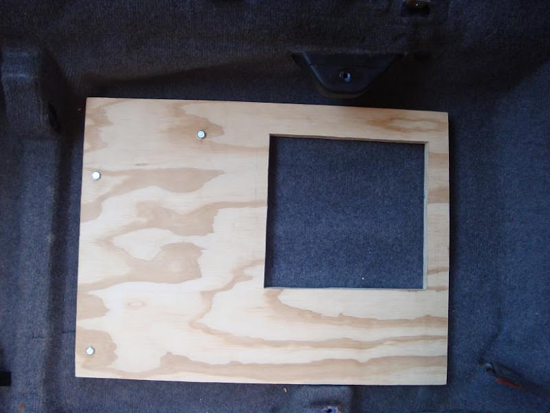

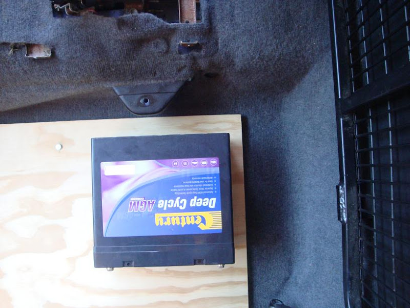

From the off cuts left over from the drawers I cut a piece that would fit under the seat so I could use this piece to hold onto the sides of the battery and also reuse the same mount holes as the jack handle:
This is the sort of space I have to play with, the battery needed to be far enough back to not hit the cable that connects the two slide latches for the rails:
Then cut a hole for the battery to sit in:

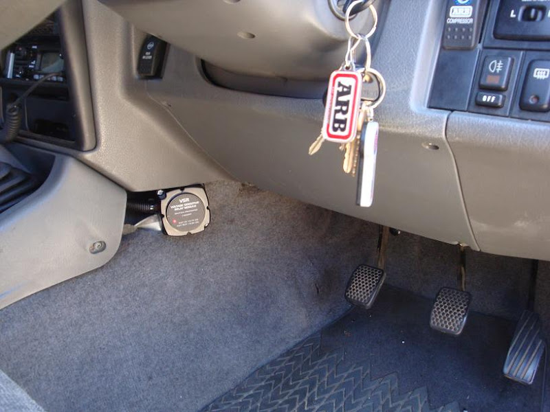

Then i made a bracket that would hold the battery isolator and screw onto a screw/bolt near the gear selector:

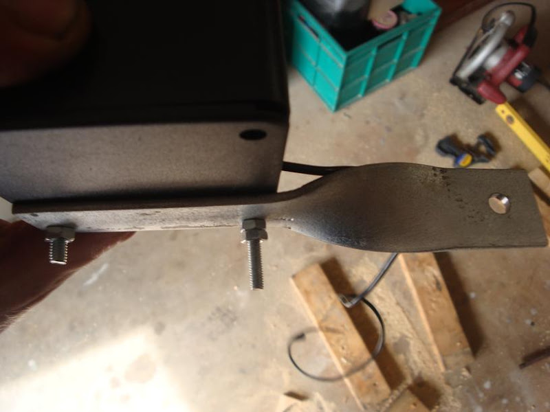

Made a bracket to mount on the top so the battery doesn't bounce out:
and job done ... well almost:

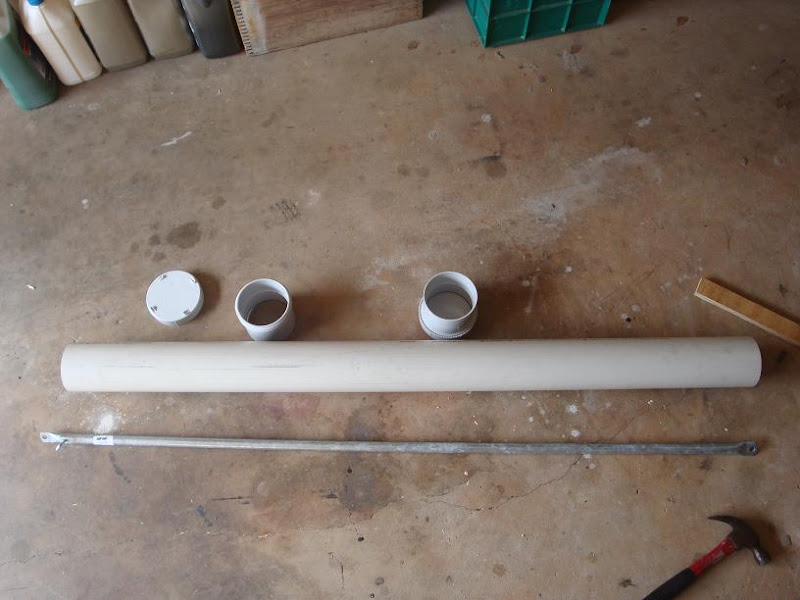

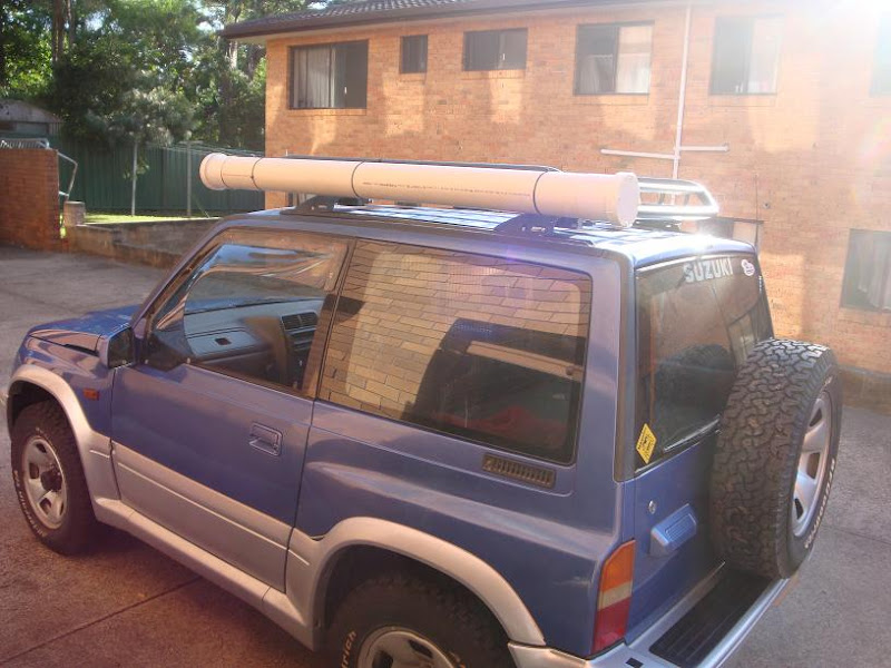

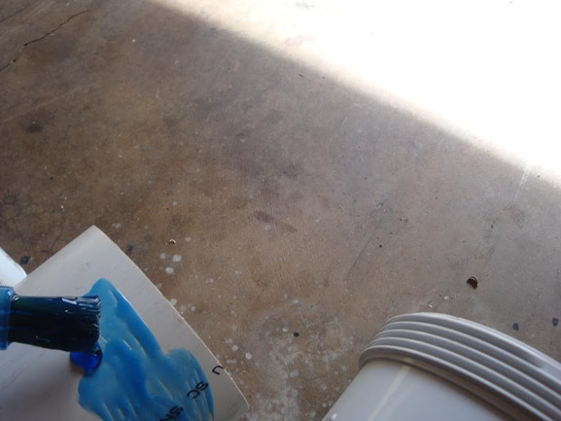

I also went to Bunnings and got a length of 100mm down pipe and some screw on ends. A 3 meter length was the same price as a 1 meter length from off the shelf - figure that one out, I needed a 1.5 meter length so I got them to cut to fit. $40 all up.
Glue the ends on:
A bit of a trail fit using some cable ties:
I had to file bit of a channel into the pipe so they mounted better on the racks, I want to get a bit more of a wear mark in and I will make it deeper.
another picture:
I am thinking of getting more, larger cable ties as they seem to be doing a good job or I may use large hose type clamps. Not 100% in this area.
Enjoy 8)

i dont realy what the timber is for but anyway, good idea. you sure you can mount them batterys on there side?

Post Posted: Tue Feb 16, 2010 12:45 am
I was under the impression that a battery can only be mounted it a HIGH ventilation area, i.e, NOT in the cabin unless in a sealed containment & ventilation's made to suit.

I don't think they do need ventilation being a fully sealed battery from what I could see?
How much did you pay for the dual battery kit, realised I sell the same relays where I work in a boat chandlery.
Post Posted: Tue Feb 16, 2010 1:55 am
AGM batteries are sealed hence need NO ventilation and can be positioned in any plane... IE: on their side or end or even upside down if need be.
They are also legally allowed to be placed in a passenger compartment as used in cars like R31-32-33 Skylines where the battery is under the back seat..
The timber is to stop the battery moving backwards and forwards plus I can use the existing holes in the floor, no extra ones. I don't like drilling any holes in my car unless it can be avoided.
Is that in reference to legality or battery operation? It is a sealed battery (glass packed, similar to a gel cell) so I thought on its side and under the seat shouldn't be an issue.
$249 is RRP for the dual battery kit. I didn't pay anything like that, my girlfriends brother manages a battery shop so I saved mega dollars. It just goes to show the mega price hike retail stores put on.

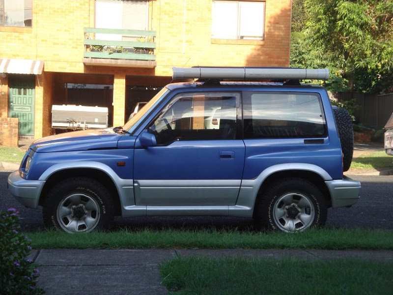

G'day Atari. I am very happy with it and I reckon it is the way to go, nice and low for your center of gravity too. I even looked at moving the air compressor but I still don't think you could fit a battery there.
Well picked up .... all the cool kids on the block have rola roof baskets 8)
I might have a crack and see if I can get something like these:

cable ties are the future... 8O
does the battery board pick up the holes for the jack handle?
Yep spot on. That way no extra holes needed to be drilled in the car.
I didn't have a photo for underneath the board but I used what I think are called carriage bolts
