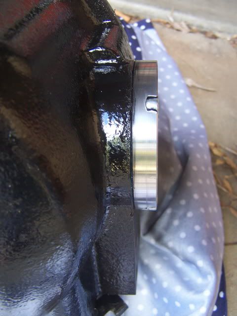

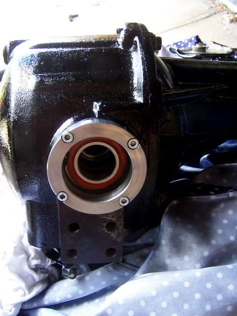

so i'm nearly done, with the bolt in RHS CV mod.
the bearing carrier is mounted, holes drilled & tapped... just need to reseal up the diff & refit it. we had to increase the circlip groove as it's slightly in the wrong spot on the original drawing for the size of the bearing or the internal circlip is fatter than the drawing & he also had reduce the length of the large spigot so the outer flange part would would bottom out in the housing.
the stub axle seems good, just need to chase up the little spring clip from the bit we had chopped off the LHS axle... the little buggers are a different size to the one RHS CV stub & the groove looks like it was cut for the LHS spring clip.

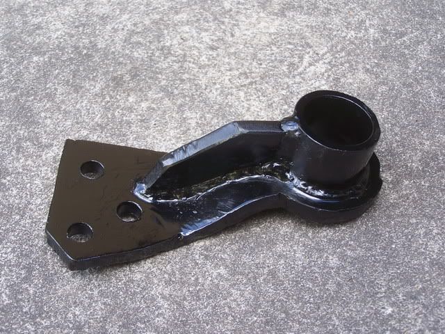

also spent a few hours of modding the calmini diff drop bracket to suit the SV420, infact pretty much ended up recreating a complete new bracket.
looking at the lengths of the Right & Left CV's + the bearing carrier/stub axle flange it appears that I will also have to run a RHS CV with the left hand bolt on cup to get it all to work.... spewing i ordered a complete LHS CV before doing the swap.
bearing carrier & bearing mounted.
custom diff drop bracket.

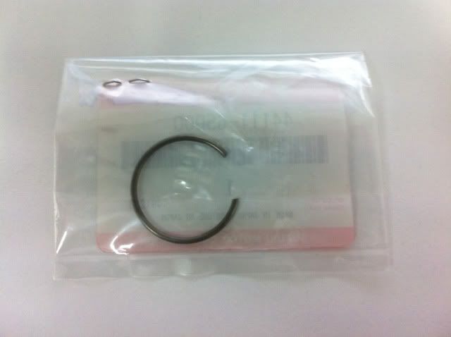

stopped past my friendly suzuki dealership & stole their last spring clip thingo... i'm pretty sure it's the cheapest SGP that they have listed on their computers, $4.75

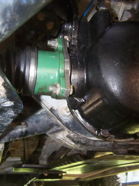

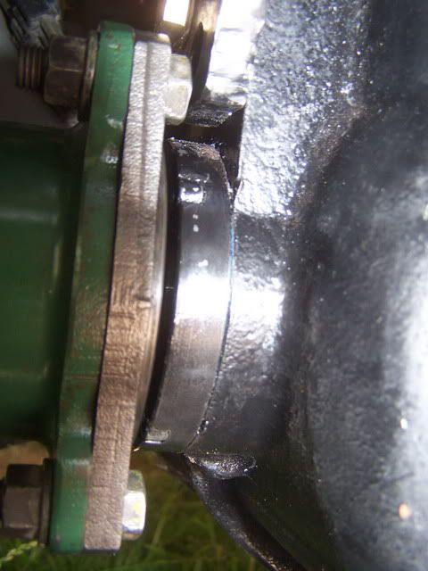

Post Posted: Mon Dec 27, 2010 11:26 am
the spring clip groove wasn't machined deep enough by the guy who did the cutting & resplining, a trip to the other side of town to chuck it in my brothers lathe fixed that pretty quick.
had to make up a combo drive shaft using the RHS CV with the LHS flange, so it kind of defeats the purpose of only carrying one spare CV around but it does make track side repairs a lot easier.
ended up having to drill & tap another hole in the diff housing & diff drop bracket as the original hole & bolt was going to get hit by the flange & bolts when spinning & had to thin down the heads on the bolts that bolt the CV to the flange...
a massive amount of work has gone into getting it done & while it's not 100% as expected with the CV's I'm glad it's done & knowing that the RHS is supported by a bearing gives me peace of mind & the ability to swap the right hand side CV with out having to pull everything off is a bonus.
