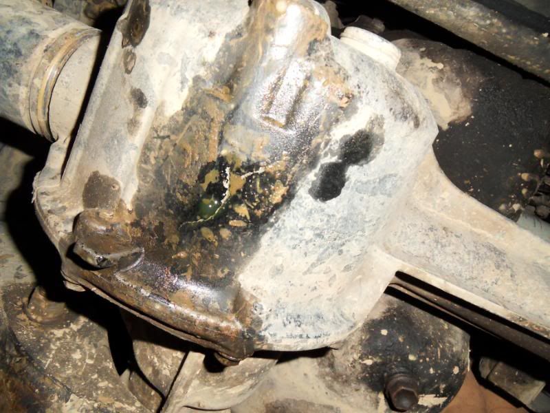

Post Posted: Sun Sep 01, 2013 10:52 am
From reading this thread, it appears that the cause of breakage of the alloy housing is from the added leverage that larger tyres provide, being transmitted to the housing mounting bolts, eventually loosening them, causing play which adds shock load to the lever, then failure. Is it common to find the mount bolts loose upon periodic inspection as described?
Have studs been tried?
Is the housing better supported in its original location, compared to dangling from drop brackets?
Do the mount bolts tend to come loose in the stock location with larger wheels?
Post Posted: Sun Sep 01, 2013 10:59 am
not always... they're just piss weak & should have never been made from alloy in the first place.
this one cracked in the housing from pretty gentle wheeling & there have been a few others that have done similar.
Chop wrote:
The crack is slightly raised not pushed in. Moved the car earlier and noticed oil where it had been sitting. Oh well steel diff it is :lol:
