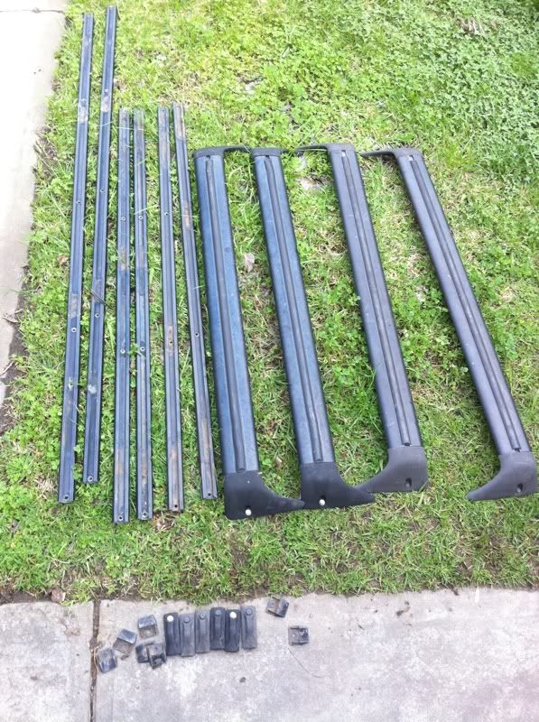

Bought some Rola racks yesterday second hand.
Came with the mounting pads. Was wondering, should I buy tracks, and install it with tracks, or use the pads. What is the advantage of using the tracks vs the pads, just that you can adjust the distance between them?
Does it give extra strength/weight capabilities.
Thanks for the writeup, very helpful.

This is what I bought.
I thought you pop rivett the pads to the roof. I may be mistaken.

Hey guys, Me again.
I got some tracks from the wreckers the other day. I've found when they are mounted to the roof racks (off the car), they sit on an angle. Will this pose a problem when I pop rivet them into the roof (which is fairly flat) and then mount the racks to them?? Cheers.
Am going to install them tonight.

Post Posted: Tue Jun 26, 2012 6:28 pm
Did these last night.
The rails are off a ford AU station wagon. I like them. The front is fixed, and the rear slide about half wau up the roof. I had a spare rack on my car (yes just 1) so I just chucked it up there too...
NOt sure if its clear from the pics. I want to also modify my basket brackets as it sits way too high.
Thanks heaps for the step by steps. Really helped alot.
Very happy with the outcome.
