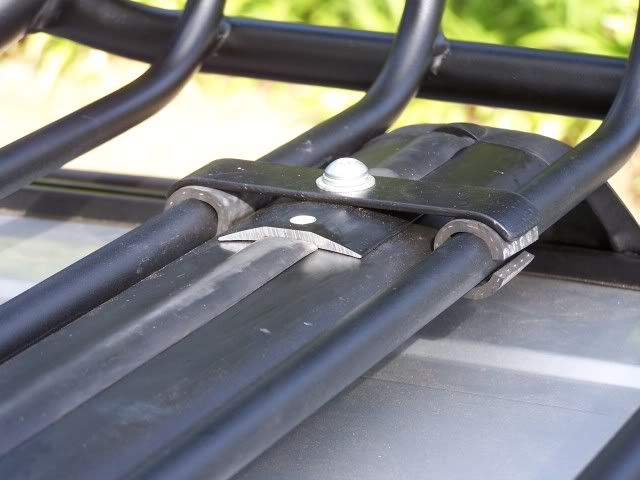

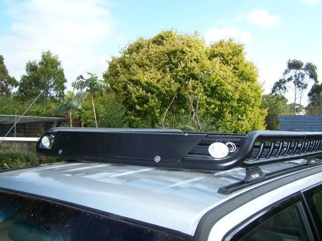

Post Posted: Mon Aug 23, 2010 2:48 am
when use my roof basket it's only got my swag, exhaust jack, alloy camping table & chair + tarps etc... IMO that's about the most i'd put up there due to the increased COG & I definitely notice it on & off road + the extra fuel consumption that goes with it, but my vit is pretty tall.
nice buy with the vortex roof basket. the rola racks fit perfectly in between the rails.

Post Posted: Mon Aug 23, 2010 2:59 am
Thanks for the pics.
I've been meaning to get a set of racks since last year and when I saw the basket in the Repco catologue I thought it's too good of a price to pass up.
I also bought a Narva flood light to put on the rear and am wanting to put a pair of spotlights up there like yours.
Did yours come with the Rola logo on the wind deflector? How'd you get it off?
'92 Vitara & Camper trailer
Post Posted: Mon Aug 23, 2010 3:06 am
nah no logo on mine, it was one of the very first one's in oz. it was a display item for a roof rack shop & sat in the show room for quite a while before i got it.
the standard mounting brackets are a bit lame & they make the basket sit up really high, i made those ones from some flat bar & rolled the ends... they probably should be a bit longer & wrap a bit more but they've done the job so far as they just hold the basket down & the rails stop it from moving front/back & the legs stop it from moving left/right, there is the alloy "boss" that slides into the rack & they have a grub screw to lock in position on the rack & the bracket is bolted to that.
EDIT: the little lights are just the $25 cheapies from stupidcheap, they are a perfect size.

Post Posted: Tue Aug 31, 2010 9:06 am
nice write up, did you add a blob of sikaflex to the bottom each pop rivet for that extra seal?
IMO you need to ditch the basket fitting brackets as with them the basket sits to high, but thats just me.
