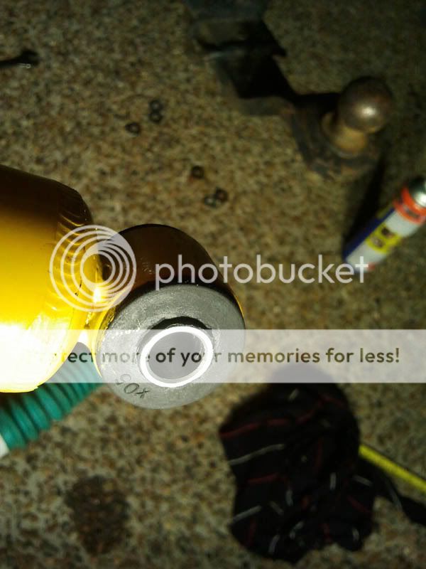

So as most of you know using commodore shocks requires a bit of modification to the bushing in order to get a 12mm ID for the vit bolt.
I bought a set of commodore shocks for a VC-VN wagon where the bush has an ID of 16mm. My solution to fix this was to get some 16mm OD 2mm wall tube and cut 2 lengths at 38mm to fit inside. I had trouble finding tube in this diameter and wall thickness.
So to plan B. Superpro list a bush for a Gemini rear upper control arm bush and the 2 crush tubes it comes with are 16mm OD, 12mm ID and 40mm long so all i had to do was file off 2mm. Part# SPF0401K. Nolathane make a bush that comes with exactly the right length and diameter tube but its about $60 vs the superpro one that needs a bit of persuasion $30
All that needs to be done once the 2mm is filed off is a bit of dish washing liquid to lube it up and slip the crush tube into the bush and its all sweet.
SPF0401K
Finished product ready to go in.

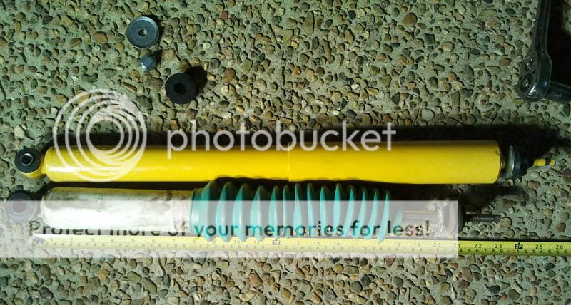

Post Posted: Thu Aug 25, 2011 1:14 pm
For those wondering, Holden Camira shocks can be made to fit.
I got some from this store
http://www.ebay.com.au/itm/2-Rear-Gas-S ... 675wt_1139
Dimensions say 338/579 but when I measured them they are larger, about 350/620? Maybe I'm not measuring them correctly.
The sleeve ID is 10mm but on mine the sleeves were glued into the bushes so I was able to progressively drill them out to 12mm and the bond didn't break. Also the sleeve width is slightly shorter than Vitara so I spaced mine out with washers.
Anyway being around 620 they might be too large for most. I have no idea what springs are in mine but I have about 600mm of clearance before the spring starts to unseat.

Hmmm..
VT commodore IRS Gabriel Pt #81865
Vs
VL Wagon Pt# 69609
I was under the impression that the VL Wagon ones suppose to be longer than the VT, There is very little difference between them and they are a perfect fit for the crush tube, no modifications required.

Post Posted: Sun Jan 08, 2012 7:09 am
I pretty sure its VL sedan thats longest :wink:
