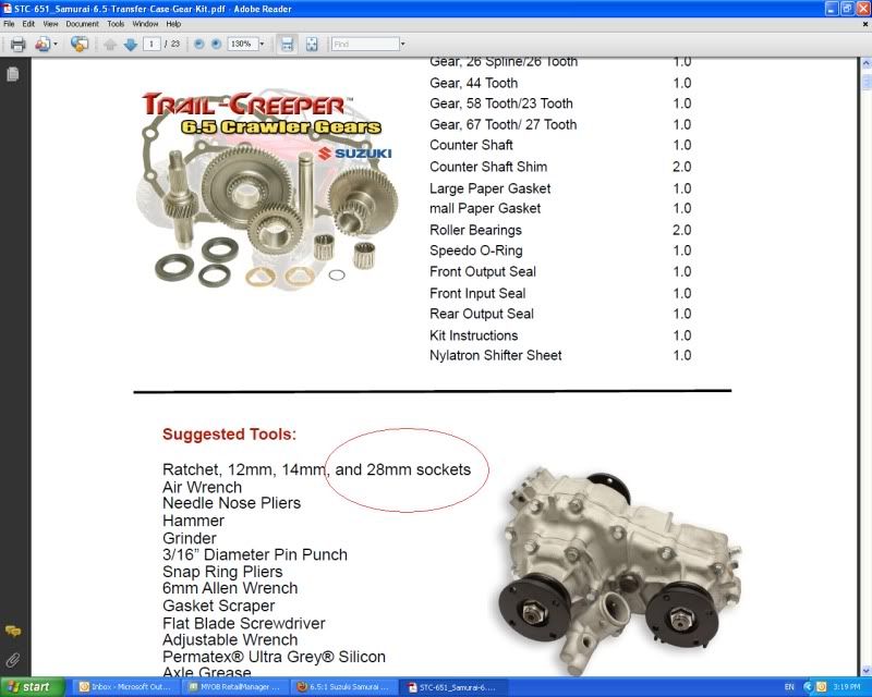

-28mm socket
is that a sierra transfer as it looks like one but they are a 27mm socket
at least mine is,
a 28mm would round the hell out of the nut.

Post Posted: Fri Oct 19, 2012 1:53 pm
Yes it's a Sierra transfer case, and yes it's a 28mm socket.
if that's the case then they must of changed the size of the nut between years as mine are defiantly 27mm nuts.

Post Posted: Sat Oct 20, 2012 3:26 pm
1.0 switch and 1.3 run the larger size shaft and nut. , the 1.0 NO SWITCH uses a slightly smaller shaft and obviously smaller nut.
NUTS ARE NOT INTERCHANGEABLE!
There MAYBE differences between 1.3 -1.3.. but haven't found two that have differed as yet.. even the drover and sierra were the same.
