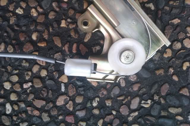

Slide the nylon spacers and plastic sheath over the cable remembering that the flanged ends face towards the plastic sheath.
Thread the wire over the TOP roller and take it all the way to the bottom to the end of the rail. Make sure the nylon spacers are in their slots and the plastic cable sheath is pulled tight.
The end of the rail gives you the cable length measurement for the DOWN position of the window.
I cut the wire a few centimetres longer than needed to give me a little extra wiggle room.
Don't cut it too short or the window won't go all the way up!

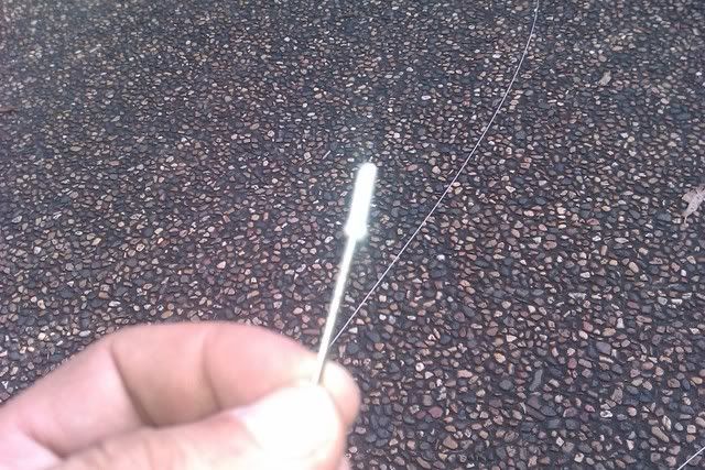

After cutting the wire to length you need to fix some kind of retaining lug to the end. This needs to be very strong or it will just pull out. Very frustrating if it comes off after putting it all back together.
I used the lug that came with the cable. I recommend soldering it on, however, my I couldn't get it hot enough so I flattened it on with a hammer and threaded it back on itself.
Remove the window carrier by sliding it out of the top of the rail, and slot your cable into place.
Here's how I affixed the cable. No way that's coming out.
