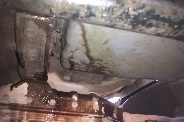

Next take a rag and clean all around the edges of the transmissions pan. Use degreaser or kerosene if needed.
Once the pan is clean, start loosening the 12mm bolts down each side and at the rear of the pan.
Do not loosen the two front bolts yet.
Gradually remove the side bolts from the pan starting at the front and working your way down to the two bolts at the back. Be careful as fluid should start to leak at this point.
Remove the two rear bolts.
Gradually loosen the two top bolts a little at a time and the pan will start to drop allowing the fluid to drain over the sides. Keep doing this until the bolts are removed.

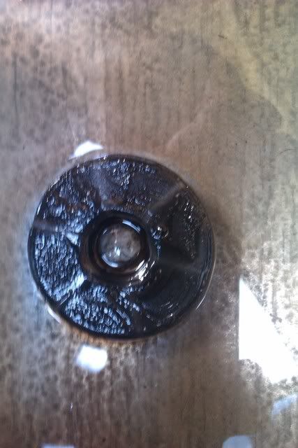

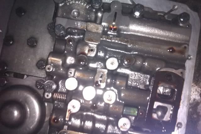

Once the pan has been drained and removed, take a 12mm socket and remove centre bolt on the filter. Then loosen the two rear 12mm bolts on the filter. Allow to drain and remove.
The filter is on the bottom right of this photo.
Once the filter is removed take clean lint free cloth and clean all the gunk of the internal surfaces.
This one was coated in black muck.

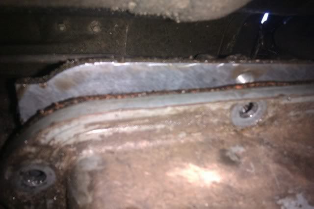

Before putting it all back together, give the pan a good clean and remove the gasket.
Remove the magnetic ring and clean of the gunk. Check for small bits of metal stuck to the magnet as it could indicate a problem. Mine was fine.
Replace the magnet and put the new gasket on the pan. I used a very thin smear of gasket goo around the lip of the pan to hod it in place.
Bolt the pan back onto the transmission using a circular pattern to tighten the bolts. Don't over tighten them!
