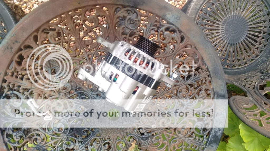

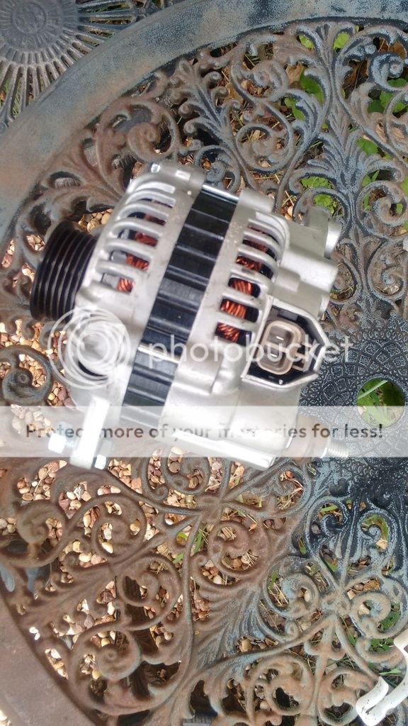

I am currently part way through doing this conversion on the wife's SWB carby Vitara, unfortunately the wreckers are closed today as well as other places that I might have found the bolts and wire from the alternator to the battery.
I'm not sure about what the alternator part number is but I looked at the photo's and found one that looked the same, it was an aftermarket item I found on gumtree that had only been used for 2 days. The part number on mine is AMG 371 0206020311 and I'm told it was from a 6 cylinder Fairlane. I had to grind down the spacer that holds the captive nut down to fit properly too.
I also discovered Repco has the 2 wire plug brand new, its part number HXK-24. I payed $23.24 for it. Apparently the plugs have a habit of breaking so its cheap insurance to me.
*Edit* looks like I worked this photo posting thing out!
Joined: Thu Feb 26, 2009 11:00 pm
Posts: 11069
Post Posted: Mon Dec 28, 2015 3:03 pm
That alternator looks like the correct one.
