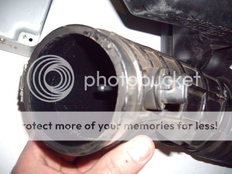

Did you get ALL the wiring and sensors? What about the IAT sensor? Its usually left on the airbox :roll:
Posts: 9719
Post Posted: Tue Jun 15, 2010 2:14 pm
Are you sure?
Mine didnt come with one. I don't run one. Arnt they all on the Intake/throttle body?
Post Posted: Tue Jun 15, 2010 2:47 pm
Are you sure?
Mine is a 2001 and it was plugged into the side of the airbox???? But knowing suzuki they had seven different locations for it :roll:
Posts: 9719
Post Posted: Tue Jun 15, 2010 9:11 pm
My wiring is for an 00' auto.. Hmmm weird.
Joined: Tue Jul 18, 2006 11:30 pm
Posts: 872
Location: West Coast
Vehicle: Zookless
Post Posted: Tue Jun 15, 2010 10:25 pm
The only wiring I think I'm missing is to the fuel pump...
Here's some more "bits".
Is this the IAT sensor? There is nothing plugged into the actual airbox.
Post Posted: Tue Jun 15, 2010 10:57 pm
Yep. You're safe :wink:

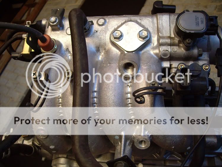

Post Posted: Tue Jun 22, 2010 7:05 am
Fitted the 110amp alternator today. Was almost a direct bolt-on :D
I used the Baleno brackets, just had to grind off a small amount.
Lume is unplugged - ready to be stripped back.
Can anyone tell me, is there supposed to be anything here?
(The threaded hole in the middle)
