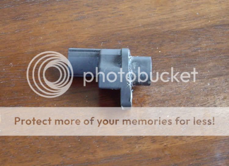

JrZook wrote:
The crank angle sensor is a critical part of the timing
I remembered that when the sump was welded, the flange around the crank angle sensor was not quite straight. Well, it was out far enough that the magnet was not picking up the teeth as they went past.
The sensor was angled towards the rear of the engine too much. So I carefully shaved off part of the rear section (a little bit at a time) until it was straight.

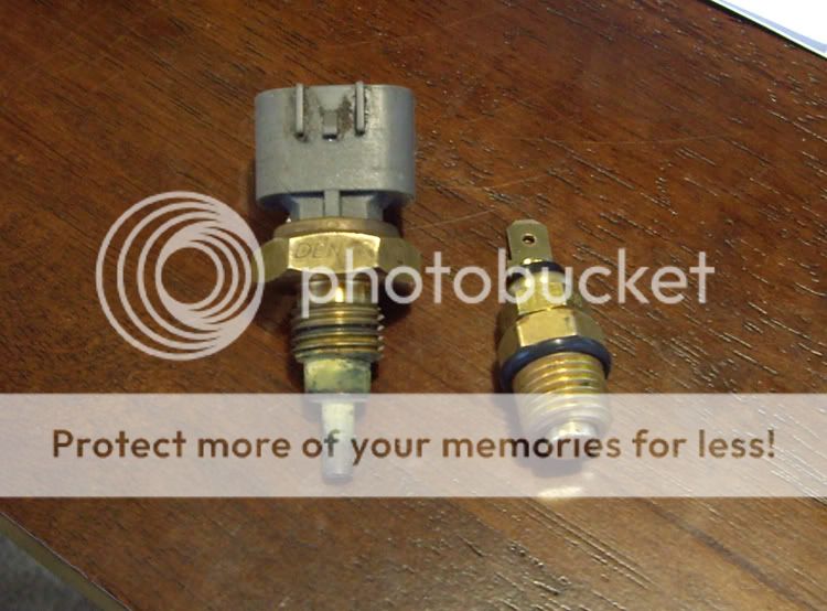

I picked up a new Sierra temperature sender today.
The Baleno sender is bigger, with a different thread too. Luckily I found an adapter lying around that fits perfectly!
The Baleno plug has three wires going to: ECU, Baleno temp gauge, and Sensor ground. The Sierra sender has one.
The engine will not run if the Baleno plug is not connected. I assume this is because of a missing ground???
Joined: Sat May 23, 2009 12:00 am
Post Posted: Sat Oct 02, 2010 8:59 am
The ecu need's that one, that's the CTS ( coolant temp sen) should still run tho. :?

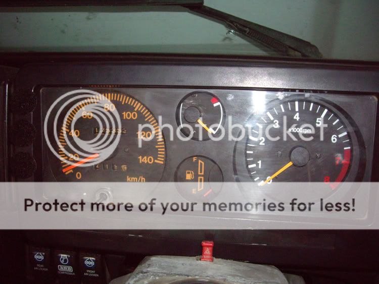

I've grafted the Baleno temp gauge into the Sierra instrument cluster.
It's wired basically the same as the Tacho. 3 wires, signal, ignition and earth - easy enough I thought...
But when I start the car, the needle goes all the way to the top. I must have accidentally swapped a couple of wires :?
Joined: Sat Jul 24, 2010 5:12 pm
Posts: 502
Location: Kingston, Tas
Vehicle: 85 Suzuki Sierra
Post Posted: Mon Oct 04, 2010 5:38 am
That looks like the bottom of the gauge to me. ~_~
Your engine bay is also unusually clean :). Very nice.

Post Posted: Mon Oct 04, 2010 5:42 am
Yeah that's a pic showing the gauge. The needle actually goes straight to the top as soon as the ignition is on.
