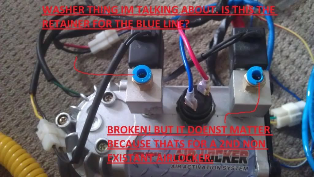

hey guys i recently recieved shipment of my chinasoong airlocker (rd88) for the front of my sierra. i have managed to find a wiring diagram.
But there are few things that still puzzle me. How do i get the blue airlocker line into the diff to the hard line? can i remove the breather or do i have to drill a hole? also what is the purpose of the yellow coiled up airline in the kit? I only received 3 brass fittings with the kit but i think i need another to go on the hard line inside the diff housing? How do you connect the blue line to the compressor? I pulled off the brass fitting on the compressor and there was a little washer that looked like it would grab and hold the air line, is this all that is required? Yes i broke the blue thing on the compressor.
I was looking at where the yellow coiled line might go to and i saw what looks to be a preassue realease valve on the side of the compressor but i cannot see how it would attach, so im puzzled as to what its purpose might be? anyway ill upload some pictures so further help you and me.
I hope these pictures have been informative enough. Let me know if you need more. Any help would be awsome, thanks.

Blue line on solenoid, you pull up on the washer, push the blue hose in, pus the washer down, that locks the hose in
to remove, push in hose, pull up washer, pull out hose
diff end
the brass piece with the internal and external thread, you have to drill and tap this into the diff housing
the metal hose from inside slides up through this, the oring slides over the metal hose on teh outside of the fitting
then the hex nipple goes in and the blue hose slides over and the cap is done up
the air housing with the thread also adjusts the bearing preload and gear backlash, it replaces one already in there

yellow hose is the chinese version of ARB's tyre inflation, threaded section will fit a tyre valve. but it appears that you have the locker only compressor.

Actually you only have to push blue hose into blue ring fittings. Don't need to Touch the washer. When you want to remove push washer down and pull the blue hose.

those "washers" you are talking about look like "John Guest" fittings, which you just shove the hose into and slightly pull to lock them in, you can get locking clips that go under the lip so they dont get unlocked inadvertently
IMPORTANT when working with these fittings, you have to ensure you have a nice square cut at the end of the hose and try not to "squash" the tip when cutting it, also make sure its a clean burr-free end. These fittings RELY on this to seal properly, there is a small o-ring in there and if you have a shitty cut, it simply wont seal. i found this out the hard way in my homebrew setup and water filters. wasnt until my cousin who owns a water shop told me what i was doing wrong. so dont use side cutters or scissors, sharp stanley knife and go around slowly and clean.
they are easy enough to replace and readily available, check out water filtration joints, they use them HEAPS. you should be able to just unscrew the broken one and fit a new one. thing to note with new ones they have a tapered thread and are 9/10 made out of plastic (VERY strong though) so keep that in mind.
