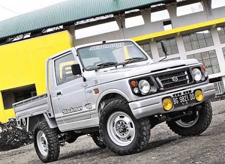

I found a some pics of utes with coily clips, but I don't know how they were done.
Posts: 7717
Post Posted: Wed Oct 19, 2016 12:26 pm
if you look at the windcreens they have no hinges, thats how coilys were done. thus they are factory built ones from over seas and wont work for you here
