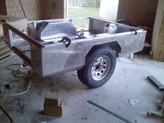

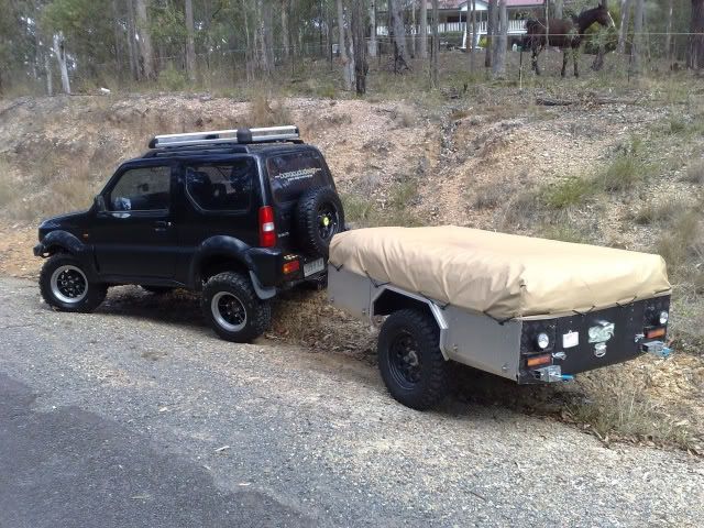

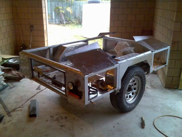

Thought I should show off my camper trailer project.
It is specifically designed for beach camping and to be dragged behind a stock engined Jimny.
I started by sacrificing my 1/2 Sierra trailer which had been my first trailer build. It was a fun concept which received heaps of interest but was not practical and was too heavy considering the space provided. Won't even talk about its' aerodynamics.
The axle and draw bar were cannablised from the old trailer, the rest was sold on ebay.
-The axle matched to Jimny axle width.
-Steel frame with Aluminium sheets and checkerplate (All hand folded and cut)
-Tyres 215/80R15 (Half way between 215/75 & 235/75)
-Canvas was bought ready to bolt on and the trailer frame was specifically built to match
-1500kg axle
The sacrificed 1/2 Sierra trailer
Body and chassis separated
The frame, chassis and floor done.
Floor is all checkerplate folded around chassis to add compartments to stop the load shifting

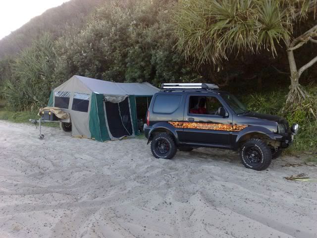

Finished trailer behind the Jimny
Second run - Teewah Beach - Double Island Point

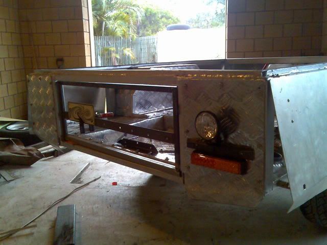

awesome... any pics of what u did on the inside?
Post Posted: Thu Aug 13, 2009 10:30 pm
Nothing to see really.
Inside is just for carrying supplies and gear. Weight was the main aim. The Trailer including the canvas camper top weighs 250kg.
All 4 corners and the tailgate open to gain access, plus there's a trap door under the camper bed.

great job.. how does it go being towed on the sand?
i wish oztrail still made the camper 2 tops they would be perfect behind a zook
Post Posted: Fri Aug 14, 2009 11:16 am
With matched wheel track and light weight it tows really well in the sand

No I threw the rear chassis section away. Worked from the draw bar back using 50x50 square gal pipe. Chassis and frame are part of the same structure, turned out super rigid. The dimensions of the box are 2m x 1.5m which is exactly the size of the frame of the Camper top.
Eventually I'll strap a water tank underneath the front half and also add a double jerry can and toolbox frame to the front.

So far so good. It weathered a really gusty and very wet storm at Moreton on the first outing. I seam sealed it before use and all seems fine. Our friends using our old tent were not so fortunate. They ended up sleeping in the car. It's really easy to erect too.

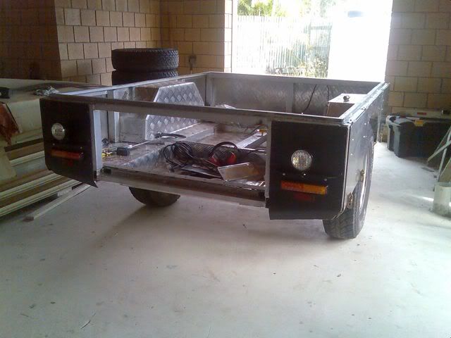

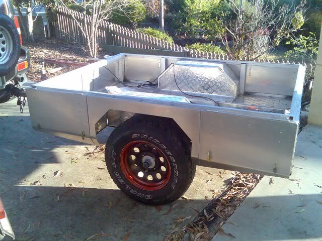

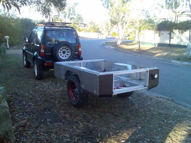

Thought I'd add a few more pics of the build and in action. I surprised myself with the end result and with what I could do with an angle grinder, rubber mallet and a borrowed mig. I started using my Super Cheap arc welder but blew more holes than joining pieces together LOL.
Last minute shopping
DI
Had just poured the slab under our house. It was the perfect workshop, sadly this space is now our en-suite.
Test run
