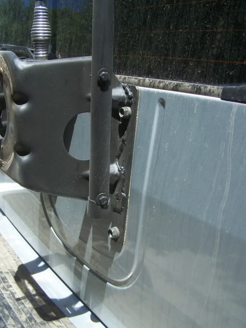

my carrier was modified to accommodate a 32" tall tyre, to do this flat bar was welded to the mounting face positioning it about 3" further up. please excuse the average looking welds... they were done with a stick welder that was about 300 years old!!! it is welded on the inside & outside also plug welded where the original bolt holes were.
once modded, clearance had to be made for the wiper arm.

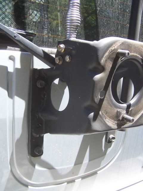

I just lifted it up higher, redrilled, put plates on inside of door,
and cut a bit out for the wiper arm.
