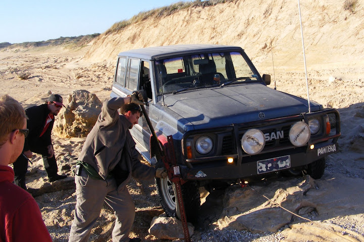

turfer or winch. hilifts suck a lot. turfers are very hard work. winches are
great and often it is no problem to use the winch to turn a car around.
turfers are really hard work. i couldn't budge this car with a turfer, i am
missing some shoulder parts but a letrik winch would have done the job a pinch of piss.

I fail to see how lifting a rim to pack some rocks, branches, coily owner etc under it to get clearance or a bit more traction can be considered a bad idea.
You get a buggy stuck in rocks you have to assit it out, you cant jsut winch it it wont move
