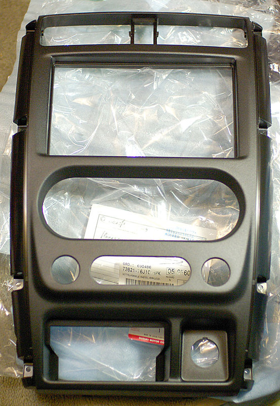

You used part number 73821-76J10-5PK. The one Wacky Will89 used was 73821-76J00-5PX. I got the impression that the PX one was the European DIN sized facia and the PK one was the Australian version. I am a bit confused now. Can either of you clarify for me which number is the European facia, the one on the left in Wacky's photo.
Thanks
Mike
Post Posted: Sat Aug 03, 2013 9:44 pm
Mike57 wrote:
PaulW
Thanks
Mike
73821-76J00-5PX is a typo.
There are 3 Jimny fascias available:
73821-76J00-5PK - Double DIN
73821-76J10-5PK - Double DIN
73821-76J20-5PK - Suits stock head unit
This photo (from above) shows the 73821-76J00-5PK fascia on the left and the 73821-76J20-5PK fascia on the right.
The 73821-76J10-5PK fascia has a slightly different double DIN opening to the 73821-76J00-5PK. This is a 73821-76J10-5PK:
I have the 73821-76J00-5PK and found it didn't fit either of my DIN sized accessories as the cut out was slightly too narrow for a neat fit.

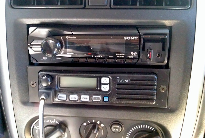

Wack_Will89 and all others that gave advice. I did this conversion late last year and very happy with the results. Would not have known where to start without the advice here. Thanks.
Mike
