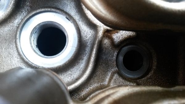

I think I am going to cry after reading this. I have a 2008 production, 2009 registered 2.4lt 3door.
I have had the cracked head and just spend 4.5k getting it replaced and all the other worthwhile things changed.
My question, do you think it likely to happen again, or the block cracking? :?

I have the head here and have it all nice and clean so will post a pic up soon for reference.

Post Posted: Tue Oct 28, 2014 2:59 pm
Link to high res http://i1294.photobucket.com/albums/b601/Sam_Whalley/20141028_181855_zps1a5419bd.jpg
Can see line running right from frost plug hole toward bolt hole.

I spoke to Suzuki NZ about the head, and block issues. They didn't really want to know, but indicated that the head issue is due to a fault in the casting that was corrected mid 2009. And the block issue was with the 2011+ models. I don't know how accurate this is but I think I will keep mine and see how it goes. Almost at 200,000kms and with the new head its running good.
If it happens again I think I will pull it out and stick in an H27 from a 5 door. :)

ok just had a call from another workshop today looking for a J24B for a kizashi which shares the same engine as the grand vitara . 38000 kms and over heated with a cracked head .
Another thing that i have discovered is that ALL the auto parts stores list the thermostat for the J24B as a 89 degree thermostat where the factory lists it as an 82 degree . check the link in the OP for the new pic and info.

Ok first of all ive seen this in all j24 not just in 1 production run . the most documented thread on this is actually on a russian site , other than this not much info is available , that is why i want to put this out there. The more people that read this and respond mean that maybe suzuki will come to the party and replace the engine .I know of so many cases where people have been out of pocket because suzuki dont recognise or acknowledge there is a problem.
