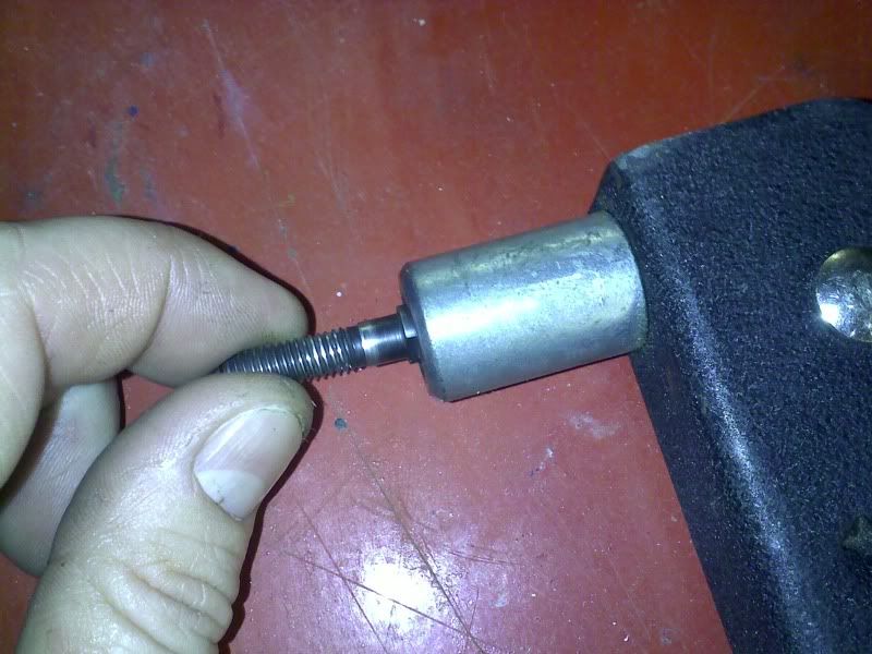

Post Posted: Wed Feb 10, 2010 3:42 am
For those that haven't seen one before I took some pics of mine.
Nutsert tool, it works very similar to a pop rivet tool
M6 and M4 mandrels
M6 mandrel
This is how it works. Screw the inner part of the mandrel into the tool
Now slide the collar over the inner part and screw it into the tool's housing
Take your nutsert and screw it onto the inner part
Now push the nutsert into the appropriate sized hole and squeeze the handles together
