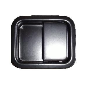

been looking around and i reckon if i can score some, i'll use airplane lap belts for the door straps.... bolt the latch/flippy part into the kick panel, then attach the plug end and a length of seatbelt to the door using the stock mounting hardware, so to take the door straps off i just need to pull the lever to unbuckle it =)
sitll trying to find my ideal solution for the door handle, which is similar to a jeep paddle handle:
except mounting that on the top of the door - so when you open the paddle it pushes the rod down on the stock latch mechanism.
Cant find anything that does that though =(

http://www.ebay.com/itm/Airplane-Airlin ... 3eff2ca69c
http://www.autoloc.com/catalog/Bear-Cla ... or-Handles
http://budgethandles.com.au/product-info/263

!!! wow!! love the seatbelt link - thats awesome...
none of the door latches show how they work though?
