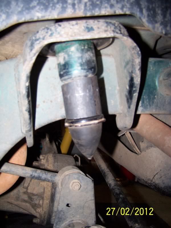

Post Posted: Wed Mar 21, 2012 4:53 pm
alexvitara wrote:
that looks wrong. Have you flexed up the diff to make sure the bumpstop still makes contact with the lower perch and doesnt foul on the coils?
I made some for the GV and i had to taper the top by just under 4mm to get it to mate up properly under compression.

Post Posted: Wed Mar 21, 2012 5:37 pm
Yeah they look wrong but they work fine. they don't meet in the center of the lower perch but they don't foul on anything. Making them sit perfect was going to be to complicated.

Post Posted: Wed Mar 28, 2012 12:31 pm
hey alex how ling did you make em? 40mm?
Joined: Sat Mar 26, 2011 8:45 am
Posts: 1602
Post Posted: Wed Mar 28, 2012 7:11 pm
55mm

Post Posted: Mon Jul 23, 2012 10:59 am
The bumpstop I made was urethane 50mm dia/ 70mm tall and bolts to the lower spring mount. after installing longer rear shocks I noticed that on compression I was getting close to full coil bind on the spring also I was at almost full compression on the shock. I made a lower bumpstop that mates with the original upper rubber bumpstop to limit max compression.
The urethane is easy to work with, it was left over from a roof top boat loader i think. It was the perfect diameter to sit in the concave of the bottom spring mount, only had to drill 2 holes on the diff to mount them and cut the roller to lenght & set some bolts and lock nuts on a "shouldered" hole in the centre of the urethane...
It's a bit fiddly to get the nuts up in the coil mounts, if I did them again I'd get someone to zap some stiff wire onto a couple of nuts so there was something to grab onto rather than just reaching with ya fingers.
The only thing I'd change is to round the top edge so it's not as sharp as it gets close the coil when flexing it up.

Post Posted: Mon Jul 23, 2012 11:08 am
for a mild sort of lift i'd look at the OME or bits4vit's bumpstops...
i drilled the spring seat & there is just enough room to get a nut & spanner up under the bottom of the spring seat & the axle tube of the diff... it was a custom spanner

Post Posted: Thu Apr 11, 2013 10:52 am
Never posted the one's I made up for the back of the old car:
50mm poly from Bruce, tapped both ends, thread from an old M10 fine bolt at top and original bump under.
These will make their way into the new car in the next few weeks, and I'll do something similar with the front.
