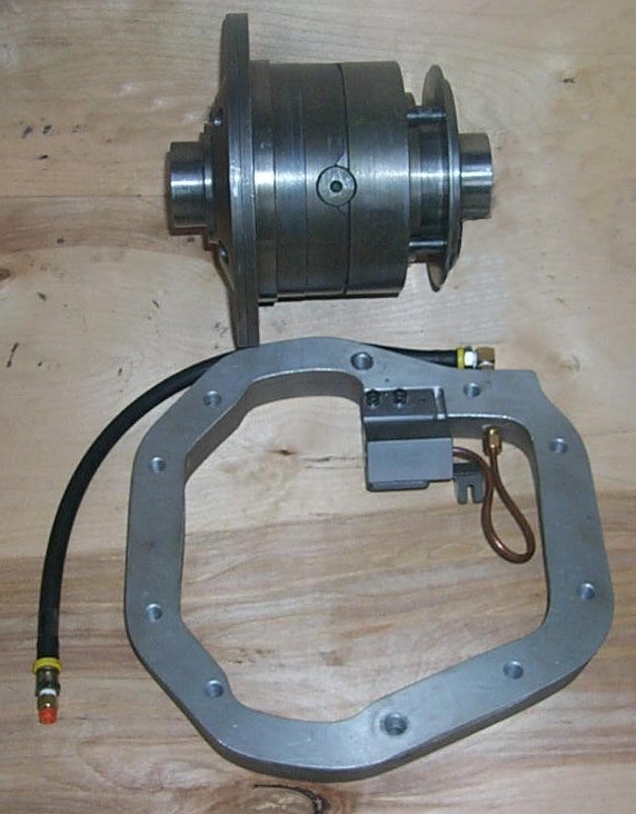

None of these are for Suzukis (AFAIK aside from the KAM) but I've been looking into it lately so here's some other types of locker.
OX cable operated locker for Danas.
Maxidrive vacuum lockers for Land Rovers.
This shows the protruding part of the centre and cut down bearing adjuster.
The Vacuum unit on the housing.

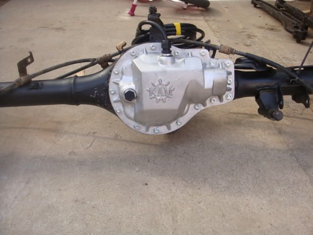

KAM electric locker. Yes I know it was posted earlier but this shows you how it works. They do make these for Suzukis, a lot of work to fit though.

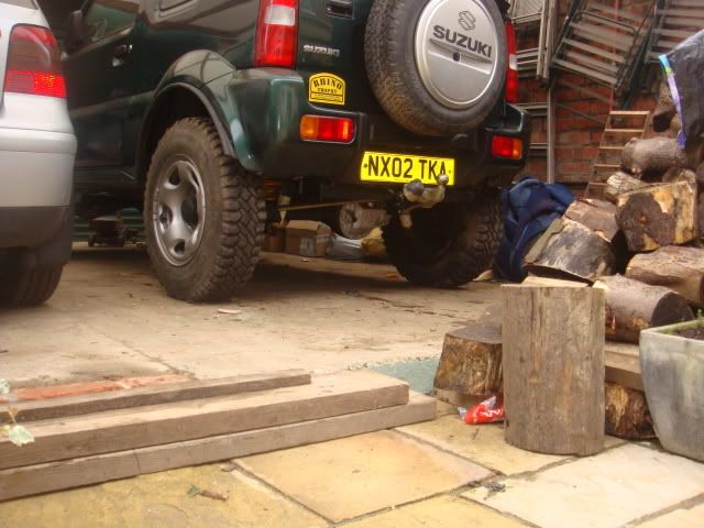

Jimny with one. :D
