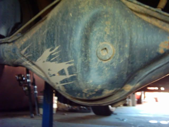

First off to do this, You will need the correct grade gear oil and a 3/8" square drive bit, I just use a 3/8" sliding T bar or ratchet and a Drain pan, You will need about 2L of oil. Buy a 5L bottle, you will be saving money especially if you replace it reguarly or are doing the front diff at the same time.
Chock the front wheels and jack the car up on some stands.

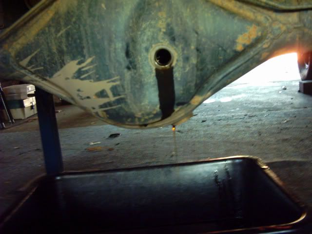

The top hole is to fill it, The bottom hole is to drain.
Place your drain pan under the diff. Remove the top plug first, It would be a pain if you drain the oil first then realising you can't undo the plug to fill it back up.
Once all the oil is drained, put the drain plug back in and tighten.

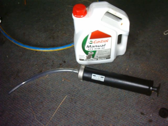

If you bought a 1L bottle, they usually have a spout that pulls out to help pouring. Alternatively you can use a funnel with a length of hose. Pour the oil into the filler hole until it starts to come through the hole. Then replace the plug and tighten.
I use an oil syringe/pump. It makes filling the gearbox and transfer case much easier. Put the hose into the bottle and pull on the lever to fill, push the lever to release.

I bought one of these from Ripco a couple of years ago,
Best $30 I ever spent, but if I ever upgrade, I'll be buying
One of those ones that you plug your air compressor into.

Post Posted: Sat Mar 12, 2011 9:35 am
my simple oil pump^^^^^^^^

Post Posted: Sat Mar 12, 2011 7:03 pm
3/8" Drive, not 3/4 :)
10mm sqaue bit actually.
Whilst the 3/8 may work perfectly fine the majority of the time. If you get one that's really tight, the slightly larger 10mm will fit better and won't slip rounding out the bolt head.
