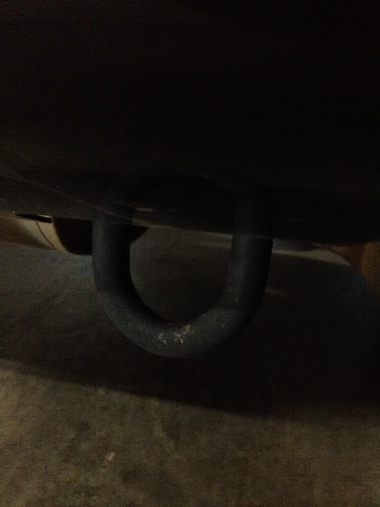

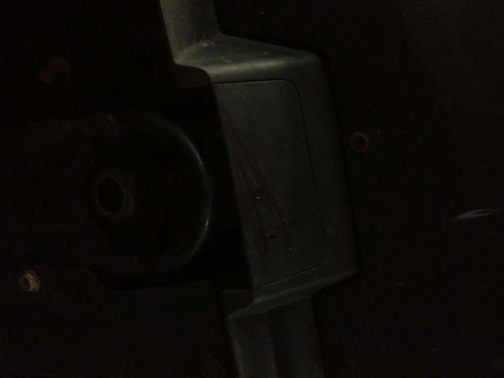

1) A recovery point is where you attach a snatch strap to. So if you get stuck, another vehicle can tow you out, or you can be towed out, correct?
2) This is the recovery point on the rear of the new Grand vitara, correct?
3) this is NOT the recovery point at the front. The front doesn't have one?

Post Posted: Thu Aug 01, 2013 7:32 pm
Tie down points for transporting.

The front has two points. The passenger side one is just a tiedown point for transport. The driver side one is a tow point but not a 'rated' recovery point, ie. not meant for snatch recoveries. However, GVs are lightish vehicles and also unlikely to get so stuck you need a full power snatch recovery. Mine's been used several times to tow me out, usually when I'm stuck because of ground clearance issues.

Just reading the manual it doesn't call those two points I've photed tie down points, it says they are frame hooks "provided on both the front and rear of the vehicle for use in emergency situations".
It says not to use them to 'tow or be towed by another vehicle on the road or highway unless in an emergency'
It certainly implies they are to be used as recovery points...
Post Posted: Sat Aug 03, 2013 7:57 pm
on-road "recoveries & towing" don't quite carry the same loads as off road recoveries when a 4wd is bogged or stuck...

They are definitely not rated recovery points as Suzuki don't provide them on any vehicle, nor do Toyota or Nissan for that matter.
