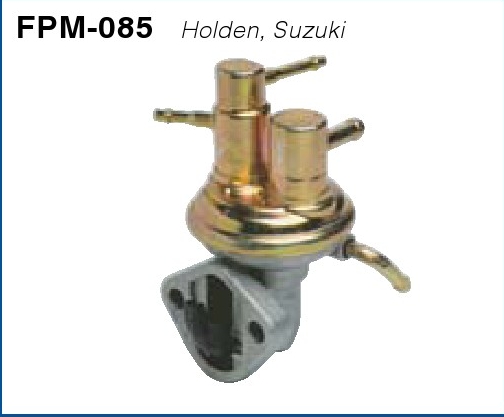

bumstein, the drain is the pipe with the bend in it coming out of the bottom of the pump in this picture:
Not all fuel pumps have the pipe, but all have the hole. The pipe is really only to direct the leaking oil/fuel away from the starter motor so it just runs down the bell housing. If anything at all is coming out of that pipe, it's time for a new pump pronto.
I have been told before by people who sell non genuine parts to only ever buy a genuine suzuki fuel pump - the aftermarket ones are apparently rubbish. They're probably still more reliable than an electric pump though. Genuine pumps seem to last around 20 years.
