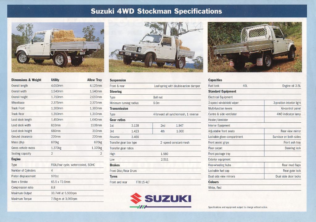

Just a stupid question, but I can't seem to figure it out. See in this photo here, the fuel tank is behind the diff, and the muffler in front, so where would the spare go? Obviously there's no swing out tailgate if on a trayback, so just wondering where one might put a spare.
Posts: 13001
Post Posted: Wed Sep 28, 2016 5:53 pm
Under the tray.
You can just see it here.
However, I also seem to recall seeing them standing up attached to the tray headboard.

Post Posted: Wed Sep 28, 2016 6:03 pm
I thought it would have gone below the tray, like other utes, but I can't seem to fathom where it could fit if the tank is behind the diff?

Post Posted: Wed Sep 28, 2016 6:04 pm
Could it fit behind the tank?
Posts: 13001
Post Posted: Wed Sep 28, 2016 6:10 pm
Did you zoom up on the photo? its above the fuel tank at the very back of the tray.

Post Posted: Wed Sep 28, 2016 6:35 pm
Your photo? There's no photo attached to your post. At least not that I can see
Posts: 2656
Vehicle: JB420, APK416, A6G415, A6N415
Post Posted: Thu Sep 29, 2016 3:04 am
Steve's post includes a spec sheet, the spec sheet includes three pictures, two of which show the vehicle from the rear and the spare tire is visible in both.
Joined: Thu Dec 17, 2009 10:30 pm
Posts: 4731
Post Posted: Thu Sep 29, 2016 7:14 am
Yup in the marutis ive had theres normally a bar over the fuel tank and the spare slides in and out on that. Unless you lift the tray there is only room for factory width spare though its a little tight
