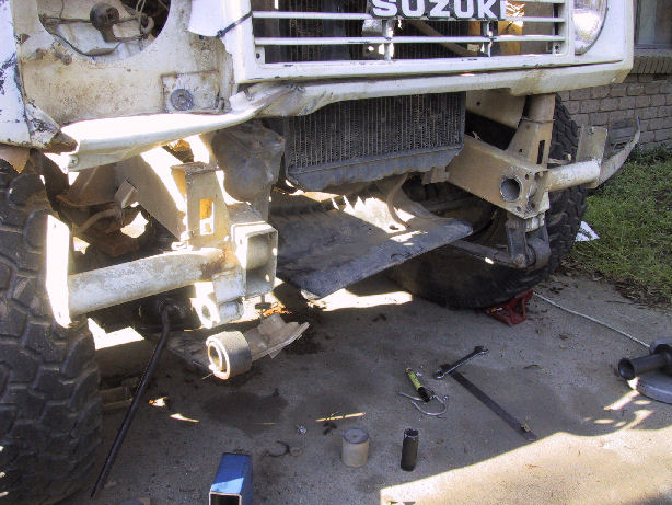

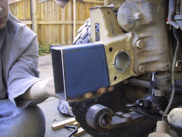

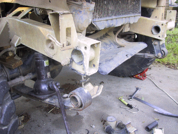

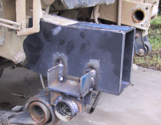

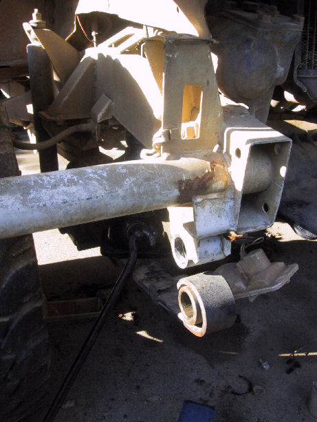

Post Posted: Thu Jan 14, 2010 2:41 am
This is how i did it. I like to do things properly right from the start, not only to keep rear mount stock and shackle angle decent, but also to make a decent mount for bullbar.

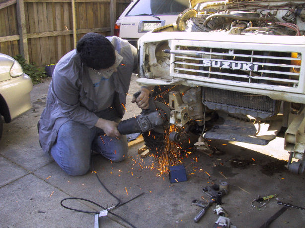

Post Posted: Thu Jan 14, 2010 2:42 am
Post Posted: Thu Jan 14, 2010 2:44 am
Oh yeh and here it is finished and painted. I no longer have that white softtop body on the chassis, i put the current green hardtop on.

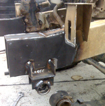

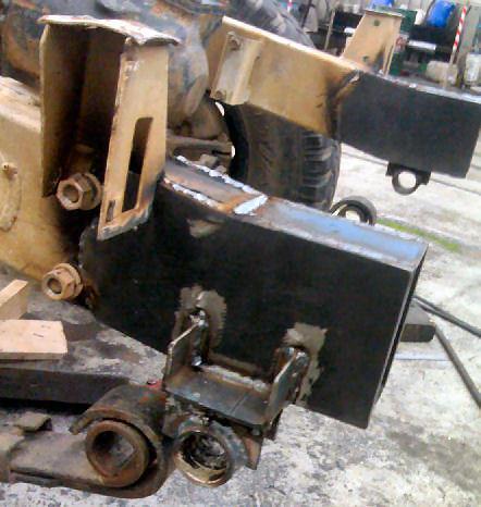

Post Posted: Thu Jan 14, 2010 3:42 am
here is one I did about 4 yrs ago. Its still going hard AFAIK

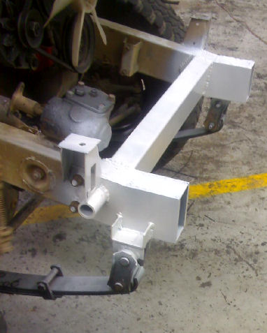

Post Posted: Thu Jan 14, 2010 10:04 pm
Here's how I do them:
I've also done them quicker/rougher, but the way shown here gets the big tick from the engineer.
RUF is the best single modification you can do to the suspension of a sierra.

Me likes Gwagensteve, especially moving the steering box. Ive found since moving the diff forwards that the balljoint on pitman arm hits the trackrod.

Post Posted: Sat Jan 16, 2010 3:12 am
itll do that... thats why i didnt move my diff too far forward so it still clears... just

Post Posted: Sat Feb 20, 2010 8:09 pm
Nice work! Looks like the way to go. Can you give some details like how much extension, how far forwrd hanger and how far forward steer box?
Also what thickness steel?
cheers mika
