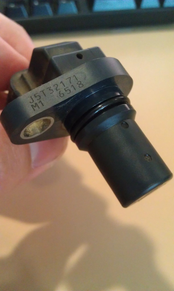

M13A crank angle sensor. Known history of 54000kms and never produced a fault while in the M13A. Part number J5T32171.

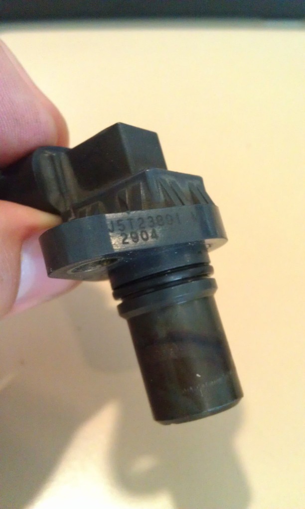

Suspected faulty M18A crank angle sensor. Unknown history, supposedly 56000kms when engine was bought from wreckers plus about 6000kms since the engine has been in the Jimny. Part number J5T23801.
Note that on the suspected faulty sensor there is distinct heat stress markings.
