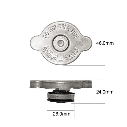

You'd have the earlier version with the cap on the radiator? That matches with the Tridon listing of "Japanese Extra Small Bayonet" style - like you mention. Mine appears to be the "Japanese Small Bayonet", which is the next size up. The only issue with the Tridon cap (quality wise, from a visual inspection) is the pressed metal top with the tabs perhaps not being cut correctly to spec. It's been driven a couple of times since and appears to be working fine and holding pressure.
This is the one you'd have CC16110:
and this is the one I've got fitted (with modified tabs) CB16110:
