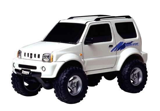

love the decals, i have a toy jimny with them on there;

Graphicx. I seen theses models on eBay. What is the quality like?
fairly ok, the upper shell is a pretty good replica, the lower bit is novelty, the kids love playing with it though but they broke the mirrors off.
