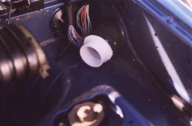

Post Posted: Mon Oct 15, 2012 1:53 am
Poita wrote:
Because the G16B snorkel pipe that goes into the engine is about 40mm to short, I need a rubber joiner/extender. But the snorkel pipe is that stupid tear drop shape.
I had the same problem when I fitted my Safari snorkel. I turned up an adapter from nylon that goes between the stock rubber and the airbox and sealed it all with RTV
