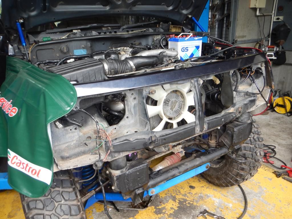

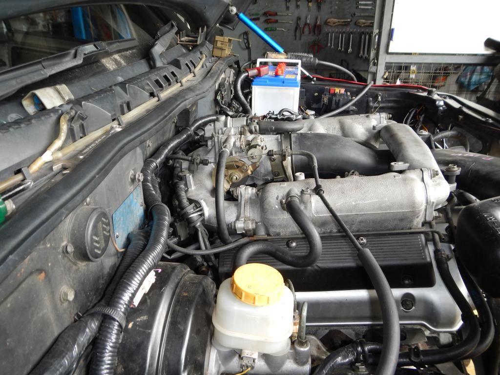

Read lots about 16B's into Shorties Vitaras and Sierras etc.
I'm curious if anyone has taken a V6 from a LWB Vitara and dropped it into a SWB Vitara?
Joined: Sun Jan 31, 2010 10:30 pm
Posts: 627
Vehicle: vits
Post Posted: Sun Aug 25, 2013 9:50 pm
Saw this in Thailand, it can be done. Might be hard to get it engineered here though...

There's a guy over on Zukiworld dropped the H27 from an XL-7 into a 3dr Sidekick, so yes, it can be done - I think his biggest problem was sorting out the wiring and getting two or three computers to talk to one another.
