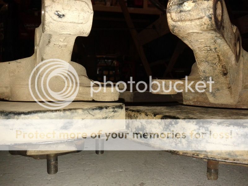

Post Posted: Sun Sep 22, 2013 3:48 pm
Rotor offset is indeed different. I did the swap on my old car and found the easiest way was to swap out the entire knuckle/hub assembly for a 2L one, plus calipers and rotors. Otherwise you will have to space the rotor out from the hub, meaning longer studs probably required, plus increased scrub radius etc.
The difference:
Also correct that it will require 16" rims unless you want to get happy with a grinder (and potentially stagger pad changes so you always have one worn pad and the caliper sits that little bit more compressed. Too much stuffing around for me, I just ran 16s and lived with the slightly limited tyre choices.)

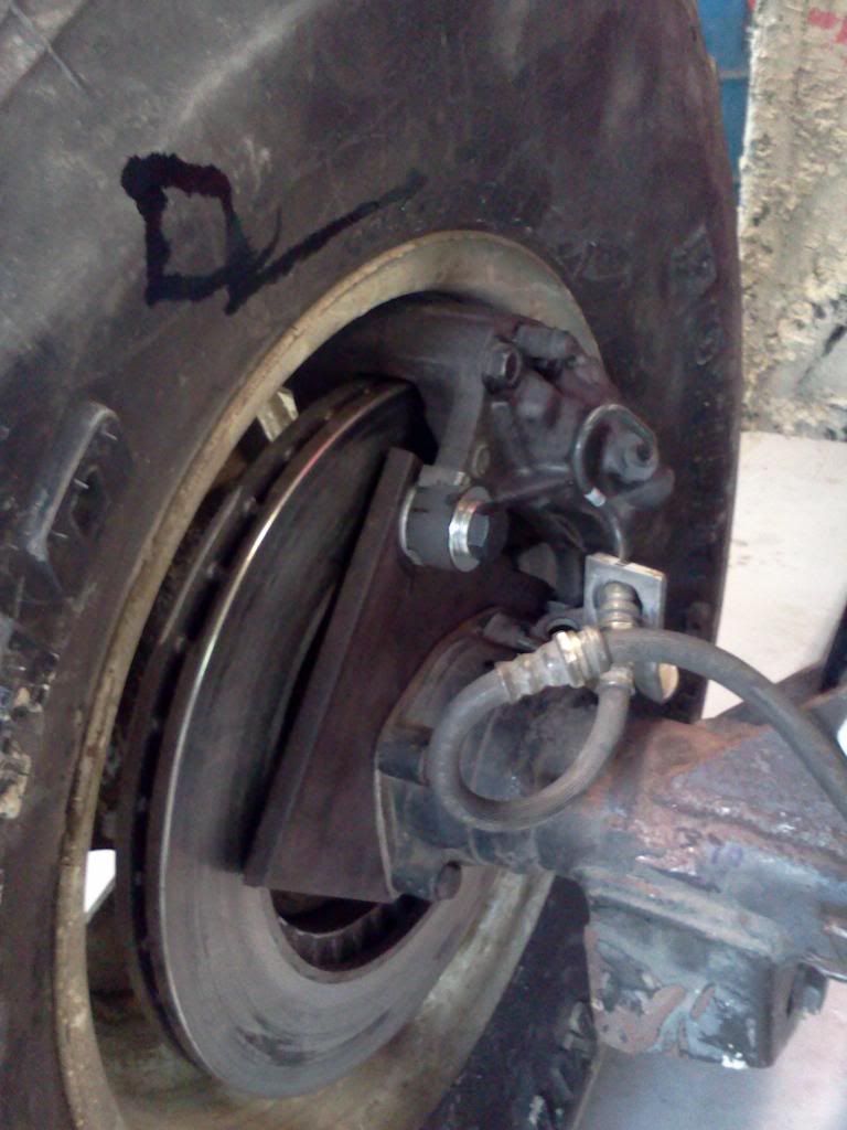

Post Posted: Sat Nov 30, 2013 12:32 pm
THIS IS NOT A ROAD LEGAL 4WD :)
After much surfing of the web and trying to mix and match some better brakes I have ended up with a V6 vitara front rotor and a Mazda RX7 4 pot caliper . This is not ideal but the best I could work out . The extra caliper housing on the outside of the rotor ment I had to install a min of 1 inch wheel spacers . The calipers only just clear the rim . Done a rear for a test fit and now off to make the brackets for the rest . Looks like all the brackets will be a straight piece of plate , much better than the old mitsi caliper bracket .
Posts: 2659
Vehicle: APK416, A6G415, A6N415
Post Posted: Sat Nov 30, 2013 11:05 pm
That's a lot of rear brake power there - overkill if you ask me...
Having more rear brake capacity than required does not shorten the stopping distance, it actually lengthens it and can also present some very real dangers as control can easily be lost.
