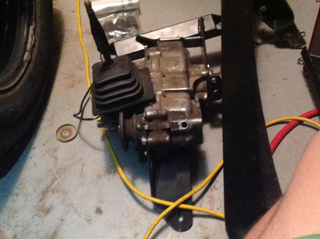

I have a WT sierra transfer case sitting at home in my garage and I want to put it into my car. Only dilemma is that it has a hole in the case as you look vertically down on top of it. It's not cracked or anything but a perfect round hole that looks like there should be a metal plug or something in there.
I was wondering if anyone may know what this is/what I do to block it up or if anyone has a close up photo so that i can compare my case to it.

Sounds like the breather.
Run a 1/4 BSP tap through the hole and screw an elbow in to run a breather - job done.

http://i1198.photobucket.com/albums/aa4 ... /image.jpg

Ahh, the breather would make sense haha. Now that you have said that I think that it would be that.
If you wouldn't mind confirming that would be great.

Checked the photo. That's the breather.
