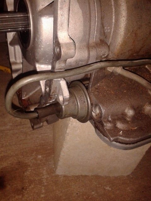

Post Posted: Thu Jul 17, 2014 8:48 pm
I've been having a dig :thefinger:
In the picture below I gather this is the vacuum line ? How secure/tight fit is this line meant to be ? As far as I can tell the only thing that holds this line in place is the bend in the steel tube as there arent any clamps and I cant see the rubber hose that slides down over the join sealing all that much :?
