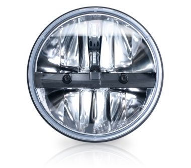

Joined: Sun Oct 25, 2009 10:30 pm
Posts: 2291
Post Posted: Mon Feb 02, 2015 3:00 pm
This style?
Posts: 9348
Post Posted: Mon Feb 02, 2015 6:11 pm
Yeah I've seen those around the $500 mark.
Posts: 2291
Post Posted: Tue Feb 03, 2015 4:17 pm
burls wrote:
thanks all for your input and not getting off track
Some good infor
As stated I am chasing a 7" replacement and was really looking for some sealed version not a H4 style
Looks like I'll have to wait a while til the prices get to something normal that a zook op can afford
The ones I posted are a sealed 7" unit
In the range of around $375, depending on how poorly our dollar is going
