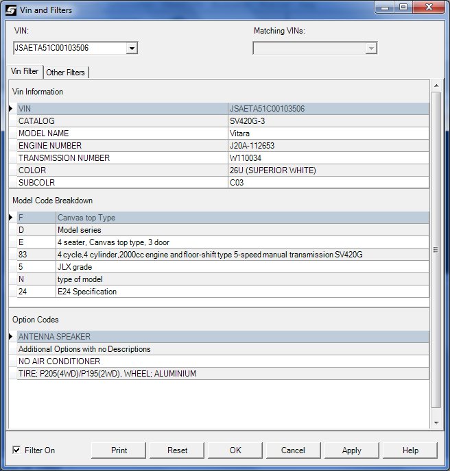

The VIN standard doesn't specify a great deal, it requires it to be a specific length (16 or 17 digits) and to start with a standard designation for the manufacturer and country of manufacture the rest is a vehicle description followed by a serial number, the vehicle description and serial number are a defined length but the format is manufacturer specific, in the case of Suzuki they vary from model to model. In the US there is a legal requirement for the VIN to be filled in in a specific manner but it doesn't apply elsewhere. The Suzuki parts database is more specific:

As far as I'm aware the front ends on the SV series chassis are identical, so it should fit. It won't fit the SE SWB, but it should fit the SV SWB - I did a part lookup on the "front bumper member", which is the steel reinforcement that sits under the plastic - it's the same part for both the SV420 & SV620 - so if the bulbar mounts to the bumper mounts, it should fit.
