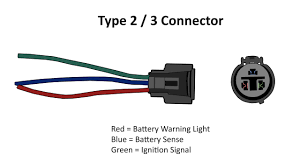

I INSTALLED THE OEX MXA325 ALTERNATOR WITH THE 2-PIN IR49 PLUG, AND I HAVE ATTEMPTED TO WIRE IT UP WITH MY OLD GTI ALT WIRING, BUT THE OLD GTI ALTERNATOR WAS RUNNING A 3 PIN MINI DENSO PLUG WITH A RED, A GREEN, AND A BLUE.
AND THIS IS THE NEW PLUG INTO THE FALCON ALT
I CURRENTLY HAVE THE BLUE[S] FROM THE OLD WIRING CONNECTED TO THE WHITE[S] ON THE NEW PLUG
AND THE RED[L] CONNECTED TO THE RED[L].
THE GREEN IS IGNITION I BELIVE, AS WHEN IGNITION IS TURENED ON POWER GOES THROUGH IT, AND IT IS CURRENLY NOT CONNECTED TO ANYTHING JUST HEAT SHRUNK UP

Red / Blue / Green on the GTi alternator plug are not the factory wiring colors
Should be
White - Battery
White / red - light
Blue / white - ignition .
I’d be checking how the connections are made back to the factory loom
Logic say that if you have the light circuit wired up correctly and you excite the alternator with a switched +12v circuit it should output when spun by the engine .
Or the alternator is faulty .
My preferce would to have a switched 12v to excite the alternator rather than a permanent 12v
