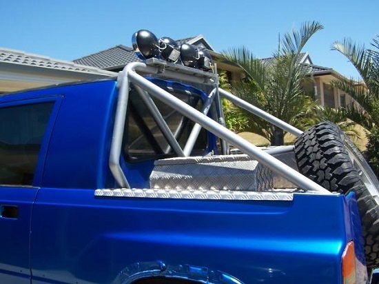

done a bit more work on the canopy today. trimmed it to size, made clamp points, and put the lid on.
ive still got a bit to do like:
marine carpet the inside of it
fiberglass over the plywodd clamp points to make them a bit stronger
fiberglass over the hinges so no one can try unscrew them from the outside
install the lock
repaint it
make a storage compartment for the jack, wheel wrench and other tools in the back
im also going to put a stainless bar set up on it similar to this one....
