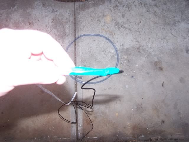

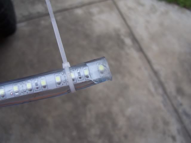

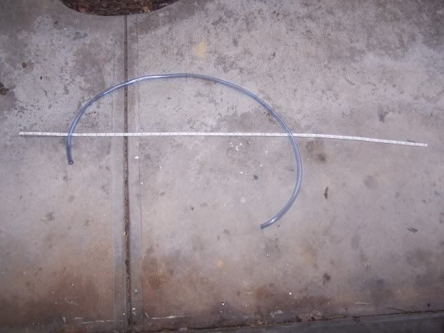

Measure & cut LED strip to length & cut a length of tubing a bit longer. The LED's can be cut down in groups of 3.

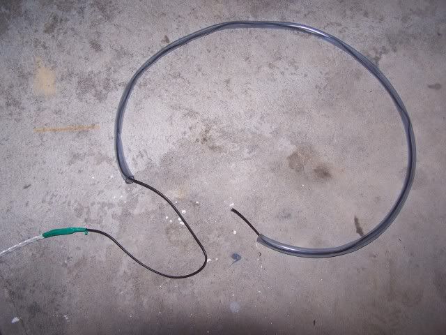

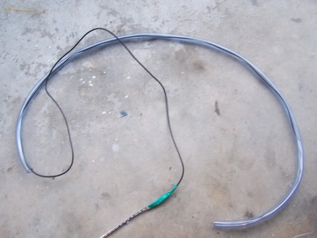

Tape a piece of wire to the end of the LED strip & start feeding it into the bong tubing. Be gentle when pulling on the strip...

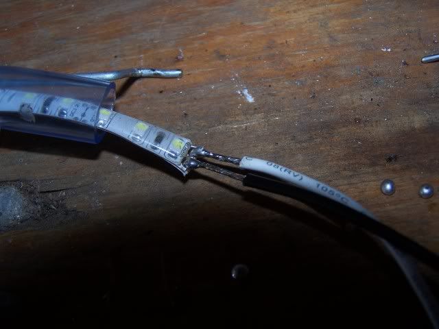

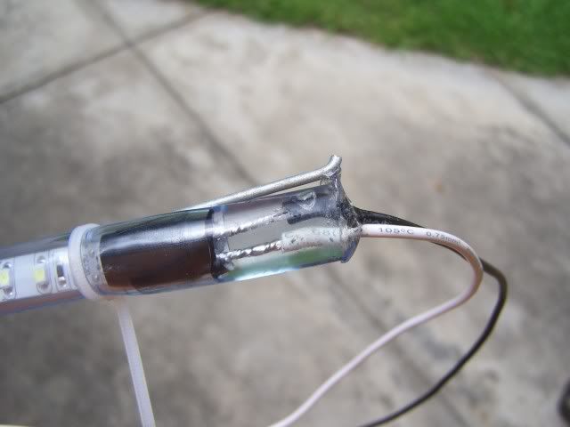

Trim back the silicone to reveal the solder tabs & solder on your wires.
At this stage I test to see if it works...

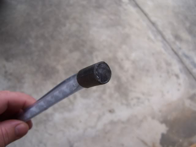

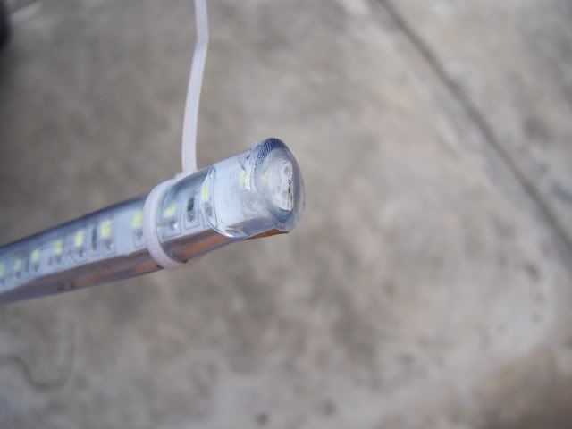

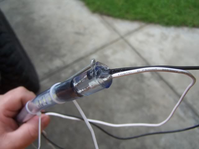

Wrap a few turns of tape around the soldered end to make a bit of a bung to stop the silicone spreading. Now pull the feed wire so the LED strip is poking out the end, un tape it & GENTLY pull the power wire end back so the LED strip is just inside the open end & feed a dob or 2 of silicone in the end to seal it.

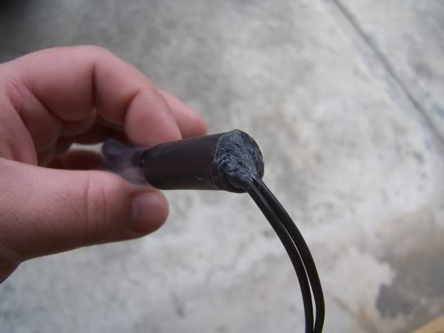

With the power end I pumped a bit of silicone in til it fills up.

I then made a set of "caps" out of irrigation poly pipe by sliding it over the bong tubing & filling them up with silicone.

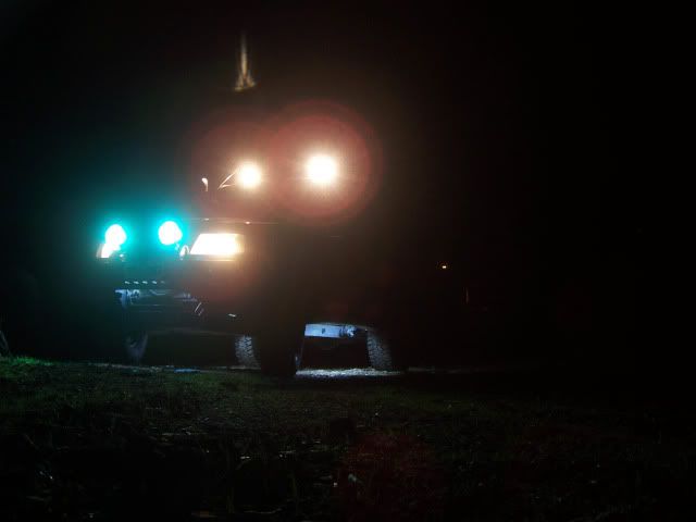

Mount them where ever you can fit them, wire them up using a relay & fuse... and marvel at the extra layer of rice added to you 4wd, now just get some NOS seat covers & some blue valve caps & the Hot4's crew will be envious.

that is a long exposure.... but yeah they're bright enough!

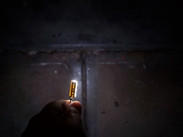

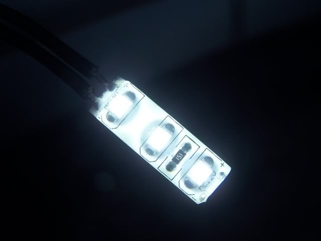

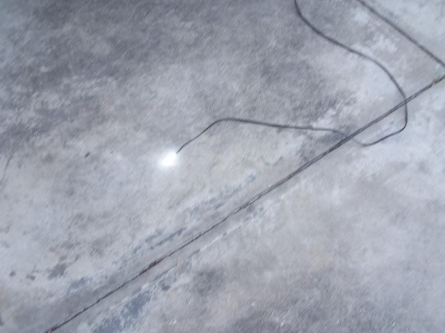

can you get a pic of a 3 led piece lit up?

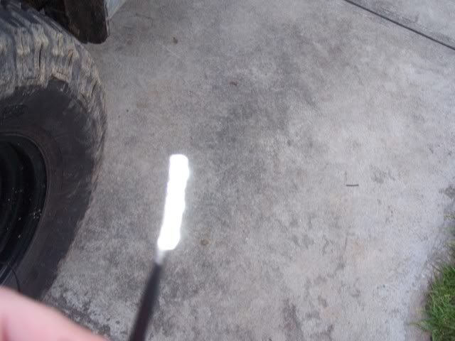

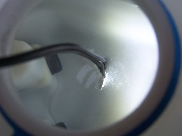

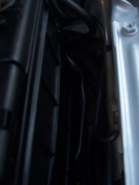

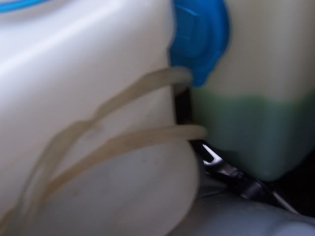

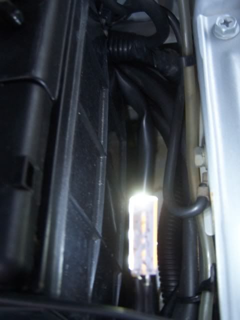

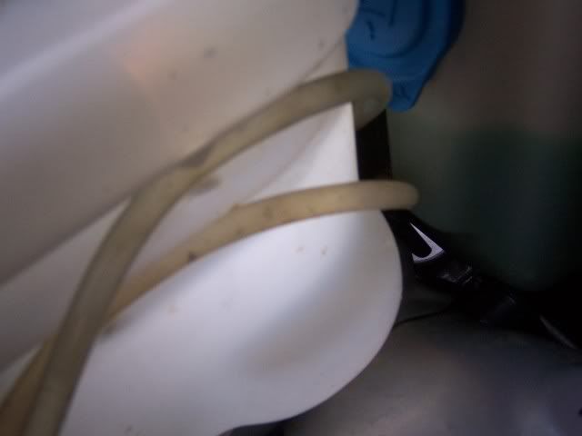

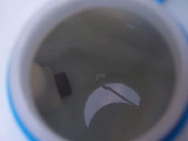

Post Posted: Tue Mar 29, 2011 1:39 am
3 led's = 25mm
looking in down next to the battery
in the washer bottle :crazy:
random hole in bonnet
about a foot off the ground

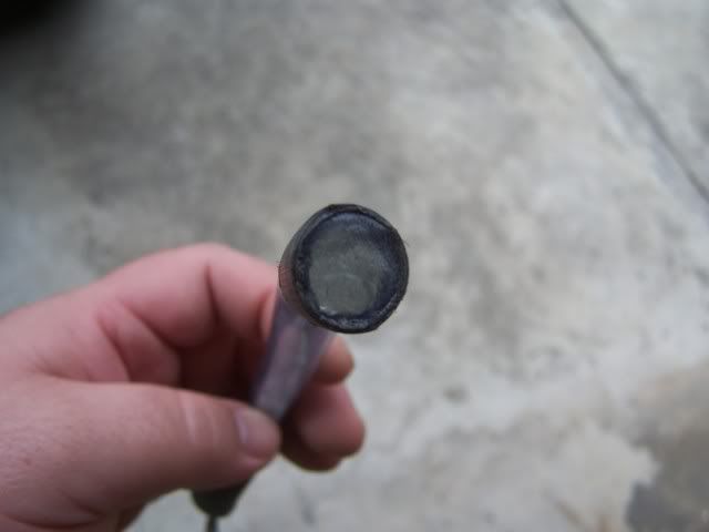

how long have you been running your in that tube, cause mine heat up alot and i was wondering how your coped inside that sealed tube??
